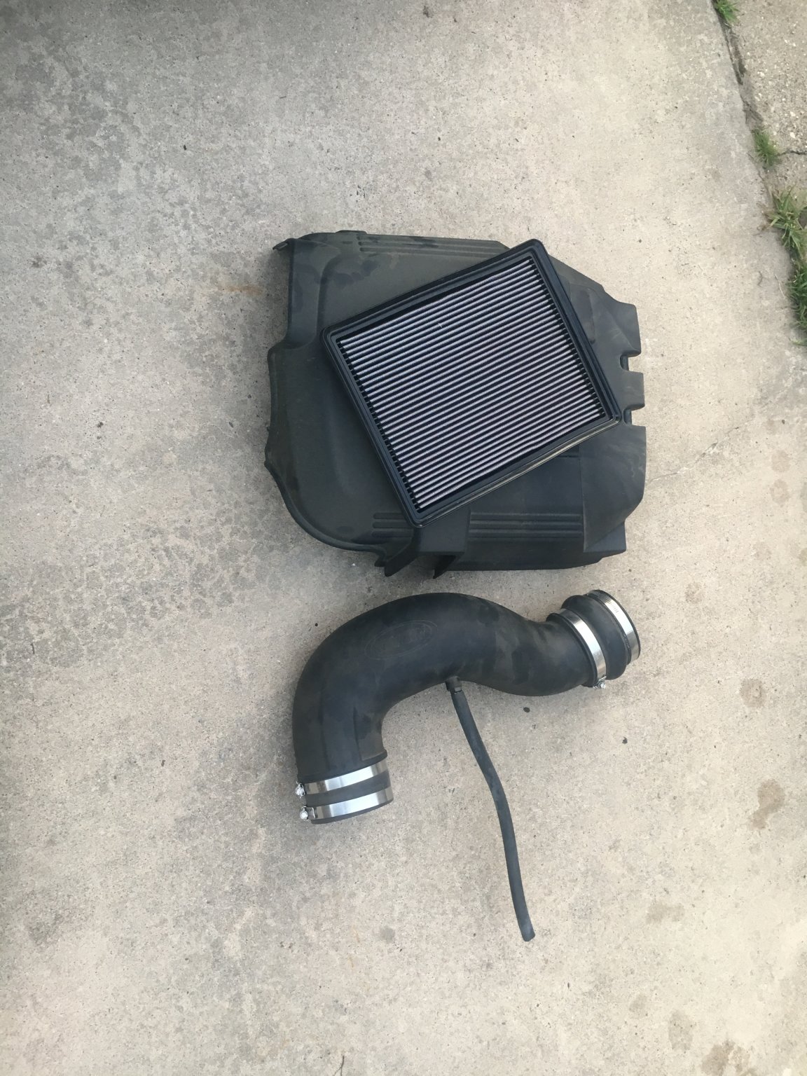

I told myself I wasn't going to do much with it but about 3 days after I bought it I found an air raid jr kit local for cheap so I picked it up and the filter.

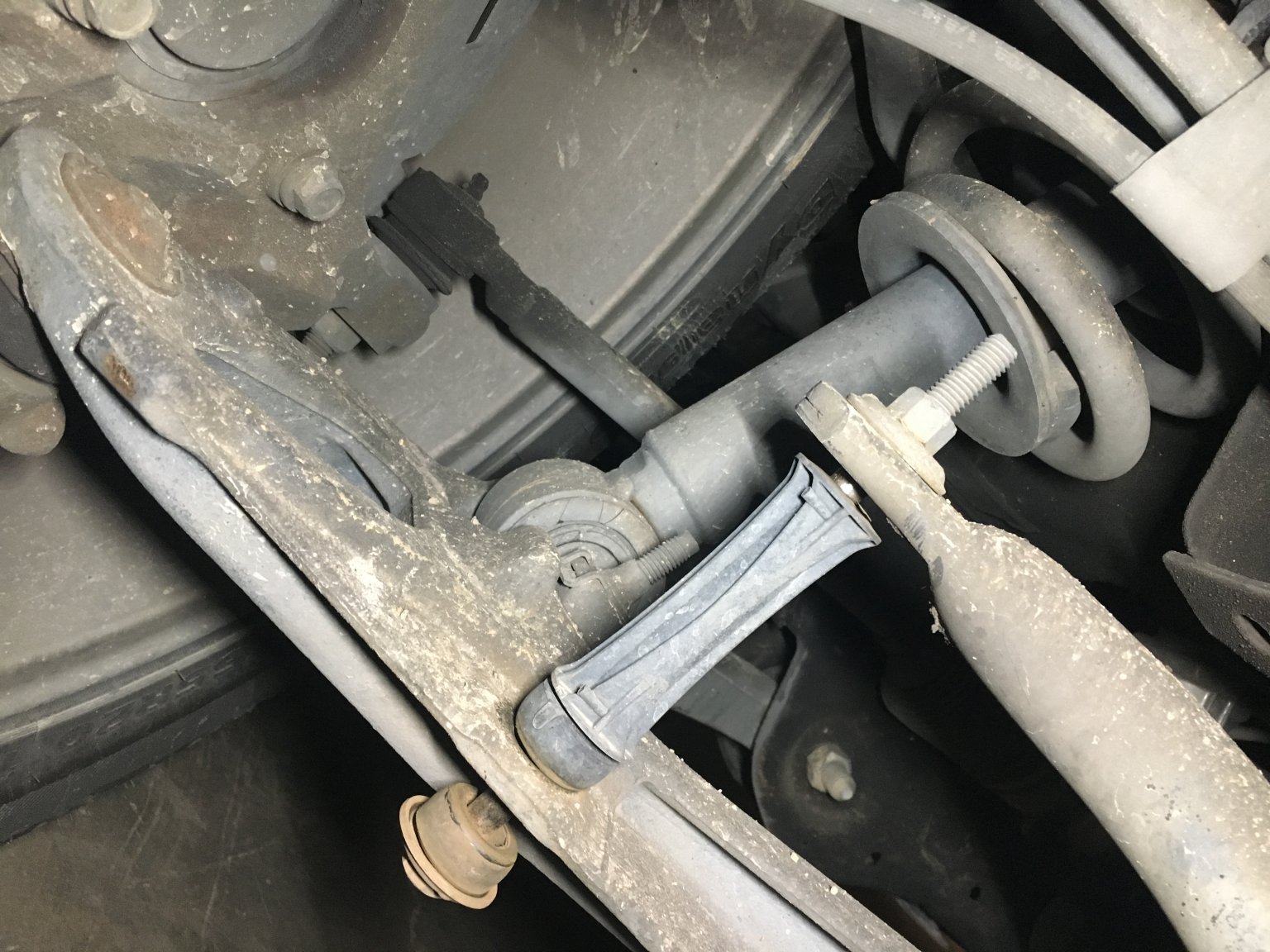

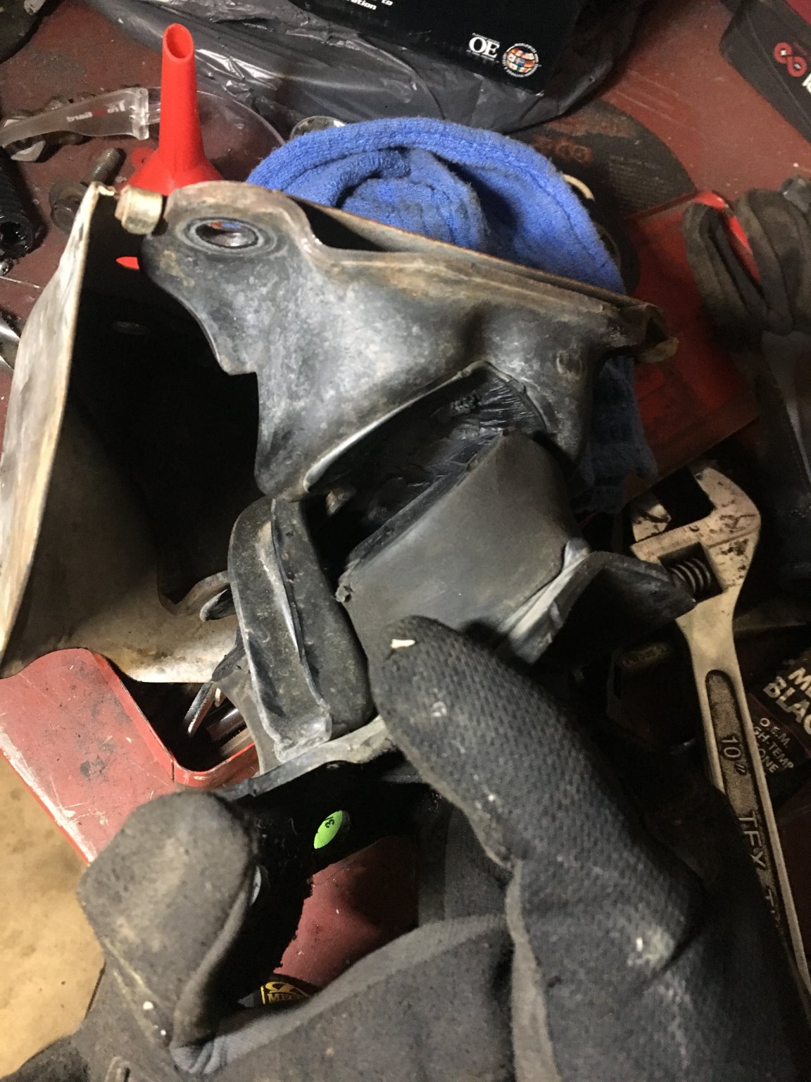

I've gotta say things have started off roughy with this. It had me a little upset but trying to keep a positive mindset as I'm stuck with it now. After i got it home me and the family decided to drive around a bit. I dogged on it a little and the shifts were harsh and trans temp rose to 200 quick. I took it home immediately and put it in the shop. Trans fluid was barely on the stick and smelt burnt. I went to the parts store and bought fluid and a filter for it. When I dropped the pan sure enough the fluid was burnt but to my surprise minimal metal shavings on the magnet. Got it all buttoned up and then notice the front left sway bar link was missing bushings. So back to the parts store got it in and replaced. At this time I thought I was about out of the woods , WRONG. I start noticing a clunking noise when taking off that I thought was u-joints. It ended up being a driver motor mount. So that's where I'm at with it at the moment

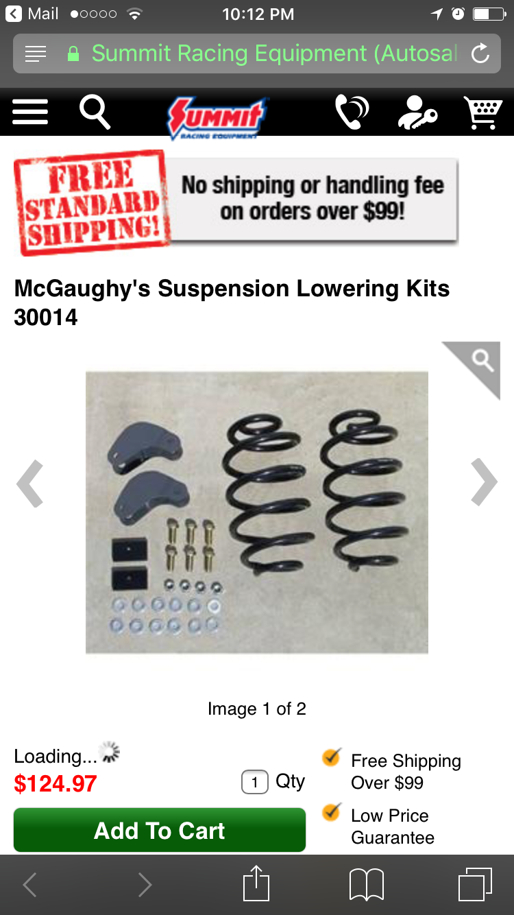

Got the motor mount done over the weekend, wasn't too bad. Hopefully be able to order the rear 2 inch springs this week.

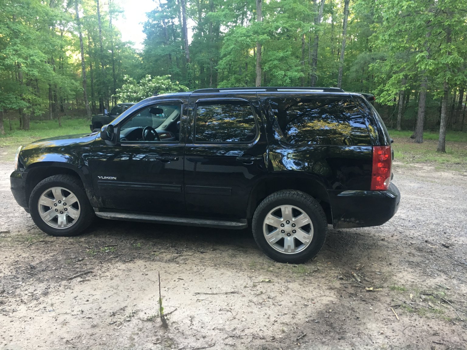

Here's a little before and after the mcgauphys springs. Got about 1 5/8" out of them, which I'm happy with. I'll also include a few interior shots aswell so everyone sees what I'm working with. I haven't made my mind up on what I'm gonna do next with it. Open to some opinions that doesn't involve spray paint, night shade, or blue lights lol.
