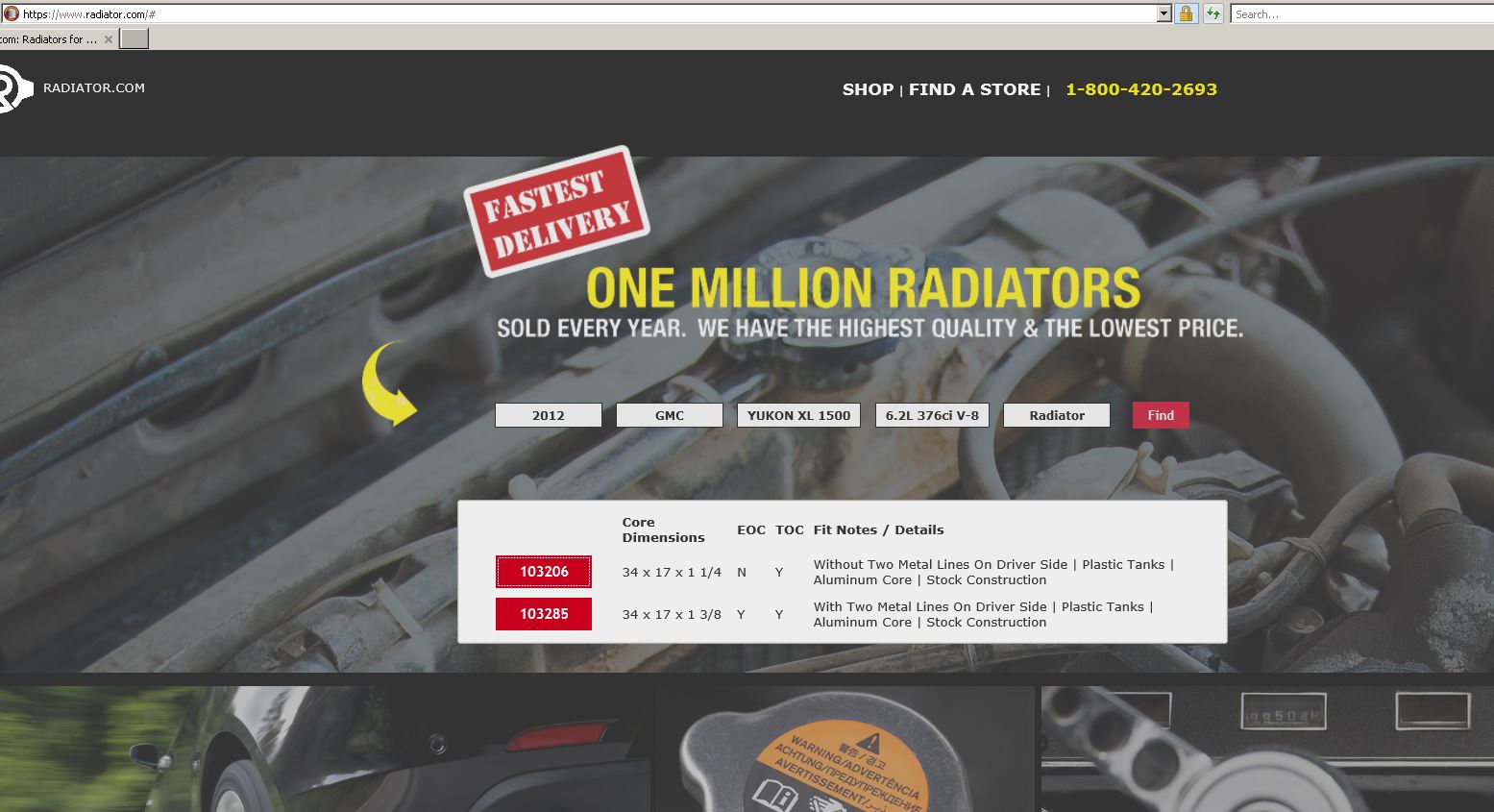

swap out your radiator, my opinion is most will get clogged up after 5 years, you can try flushing it and running some chemicals thru it but it might not do much good if you haven't already been doing that annually.
1800radiator has a 1 3/8" radiator with both trans cooling and oil cooling lines (if you are so equipped) if not it doesn't matter it will still work
they have also added a drain **** that GM so thoughtfully deleted
and it has a lifetime warranty
choose #103285 it will fit all 07-13 Tahoe, suburban, Yukon, Yukon xl, escalade, escalade esv. and probably many other full size trucks
