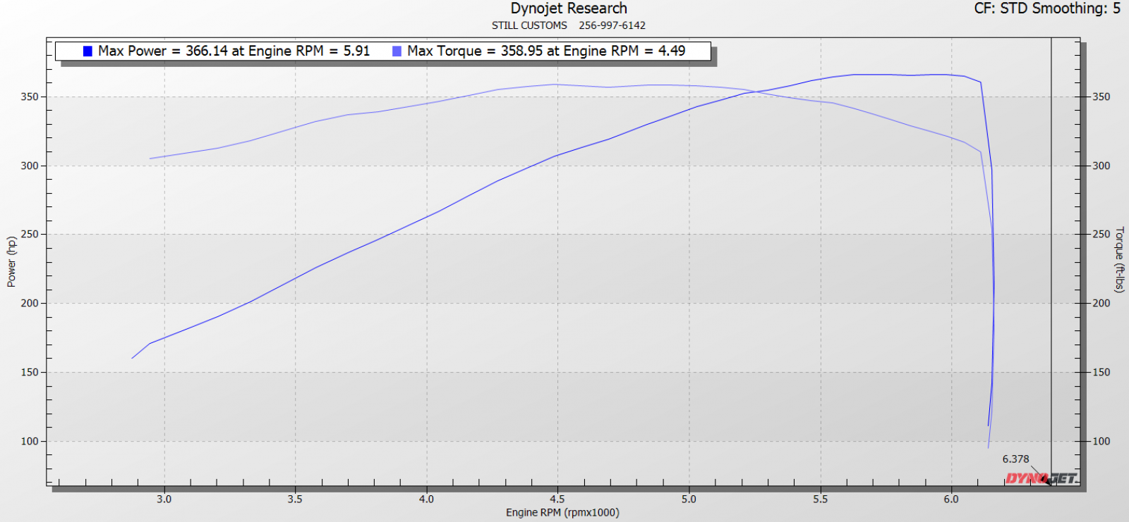

Here is a YouTube link of the first Dino run for the Escalade build. 366 hp at rear wheels, 452hp figured at crankshaft. Nice flat torque curve. 359 max torque at rear wheels.

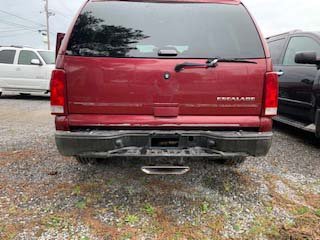

We drove up to N. AL Sunday afternoon to deliver new seat covers from leatherseats.com and to check progress on the Escalade build. We're getting close. The builder, Brian Scott, thinks he will finish it in the next 3 or 4 weeks. Right now its in the bodyshop for paint work. They have repainted all the cladding, rear bumper and grillwork. Next they will recondition the remaining of the paint which includes new clear coat.
This video captures the sound of the dual exhausts. Exhaust system includes shortie headers, OEM cats, 2" pipes, dual in/out muffler to center exhaust tip. I like the growl of the exhausts. Not too loud, but definitely not stock sounding; kinda mellow and aggressive at the same time.
