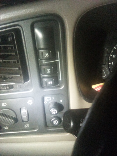

AWD was only available on Denalis and Escalades. To know quickly, if you have the 4WD switch on the left side of the cluster, you do not have AWD.

i have all wheel drive only options i have are 4 low all wheel and no traction control...

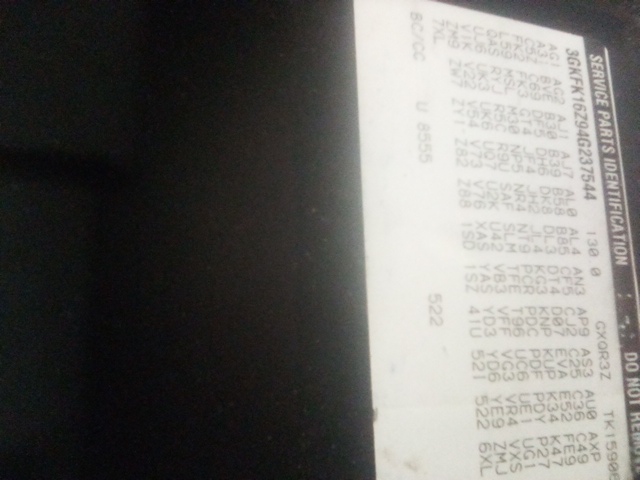

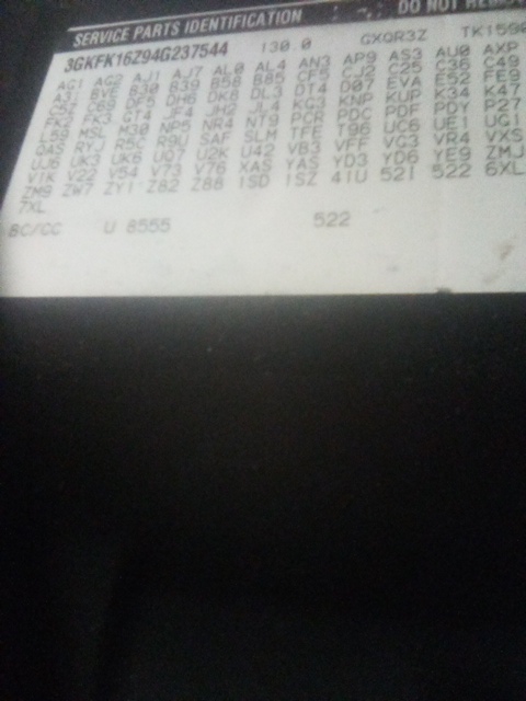

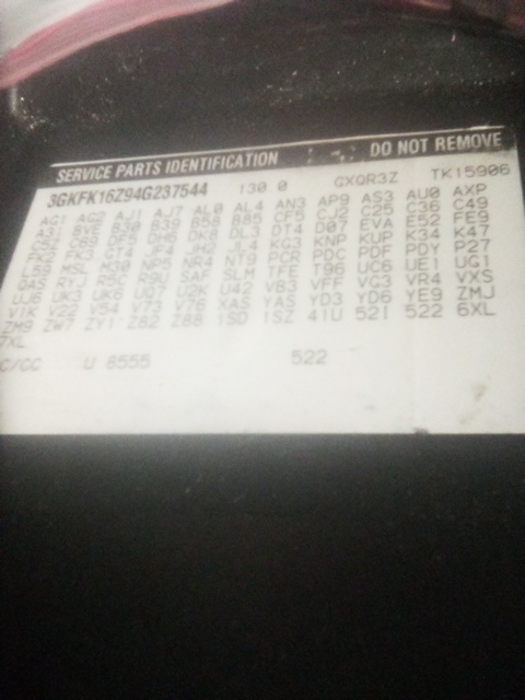

Look at the inside lid of your glovebox at the RPO codes. Do you have NP8, or NP2?
When was the last time the spark plugs and oxygen sensors were replaced? Was any recent maintenance done right before this all started?

changed spark plugs and wires not long ago fule filter and bout to do the fule pump soon 43 psi was shutting off on me on my 4 hour rides weekly started with plugs and wires then fule filter it helped but still get these codes and the misfire untill i put it to the floor litterally and i will go see what rpo codes i have the maf will come net too
