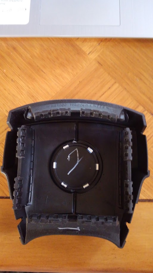

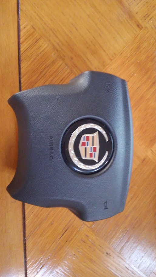

Took care of the ~$100 airbag problem. A little disassembly and ended up with the only part that was important to me for $11. The whole airbag assy comes apart very easily. I was working gingerly as I wasn't sure if it was going to go off or what.
