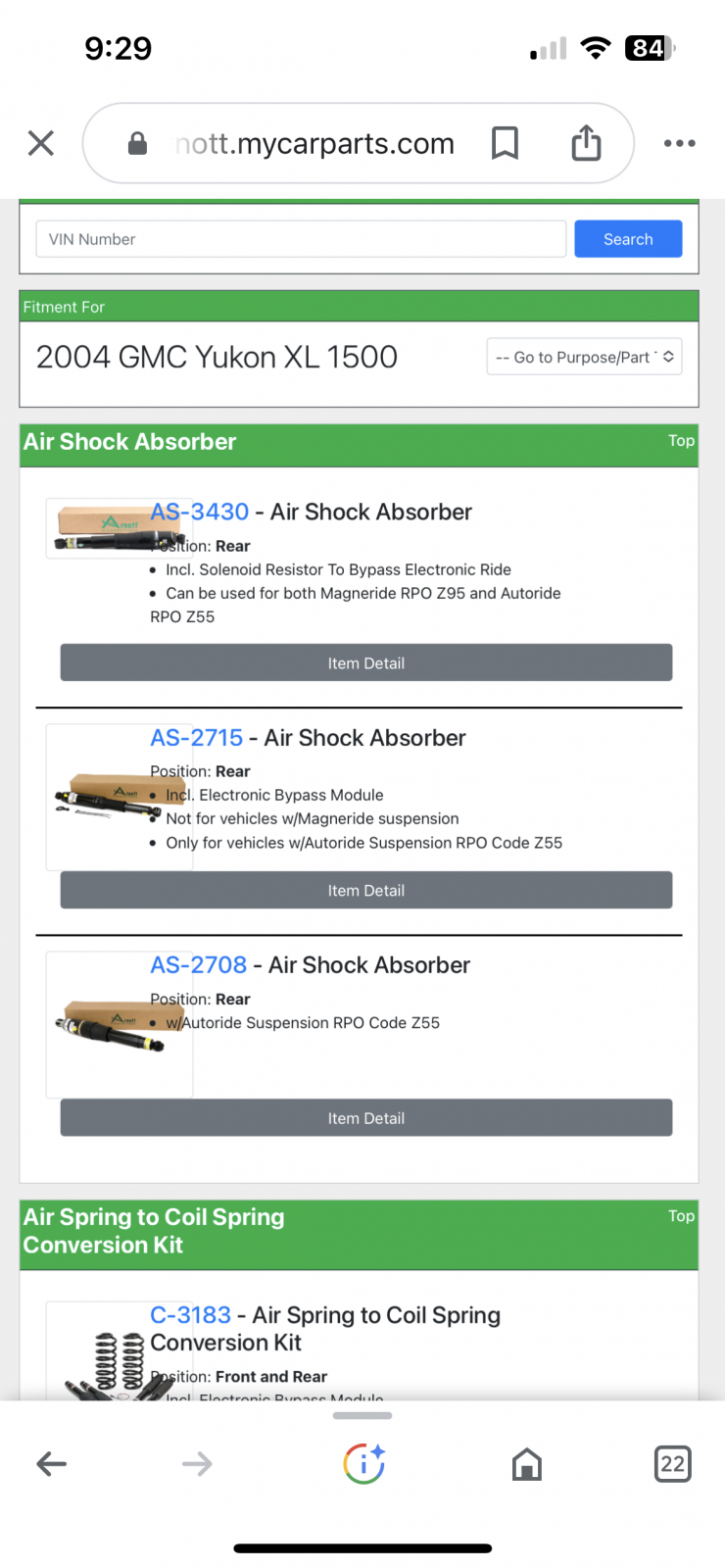

Looking on RockAuto, they show the Arnott reman rears as PN AS2708.
I shopped around a bit and found them cheaper at Summit with free shipping. Same part number.
But, on Summit, when I use the "make sure it fits" button is says it does not fit.
They clearly have the self adjusting feature as required for the Z55 suspension.
Anyone order that part number from Summit? Any reason to believe they won't fit?

Go to Arnott’s website and they will list the AS-2708’s for your 2004 Yukon. No idea why Summit says they don’t fit, but I’d trust the Arnott site.
