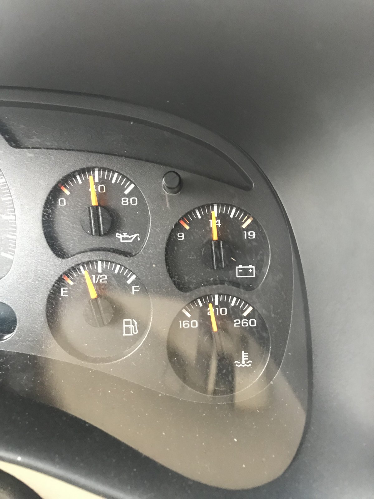

I just picked up an 03 Tahoe Z71 With 180k on the clock. Runs very smoothly, and there are no check engine lights. It is the 5.3. I seem to be getting pretty crap fuel mileage, 12-13 around town and 14-15 highway. I have a fresh air filter, fresh oil change, I have ran Lucas injector cleaner, removed the Maf and hoses down with Maf cleaner. She sits on stock size tires at recommended pressure. Temp runs like it has a 185 t-stat in it, but I don’t think that should make THAT big of a difference. What gives? I was hoping you gurus would have an answer.

What kind of fuel are you using? And how do you drive it? Honestly, your numbers are pretty average.

Do you have a traction control button? If so try turning it off.
Also, do you have a scan tool to look at your live data? You might look into your fuel trims and O2 sensor data.
History on plugs/wires? Any way you've got a brake caliper dragging or a beating going bad?

I haven’t changed plugs/wires yet. No sign of a misfire though. The motor runs smoother than my 2014 HEMI. They are next on my maintenance list.
The truck runs incredibly straight and smooth. Wheel bearings are perfect. No sign of a sticky caliper. I will jack it up and check to be sure when I get a chance.
I only have a basic code reader. I could take it to a shop, but I am trying to avoid the cost.
I wonder if the o2s are bad enough to run super rich, but not bad enough to trigger a code?

A code will not usually appear until one of the long terms hits the +25 limit, at which point it will trigger a 0171 or 0174 lean code.

I wish I got that good a fuel economy reading. I get 9 around town and 11 on the highway, with a tail wind. However, I have some really NASTY off road tires that eat snow and mud. Now, a cooler thermostat is BAD mojo on a fuel injected engine. You MUST run the OE temperature thermostat. FI uses "open loop" mode to compensate for the lack of a choke. Your computer is pumping extra fuel into the engine to try and warm it up. I have seen substantial changes by going back to the proper heat range. Your heater will work better too.
