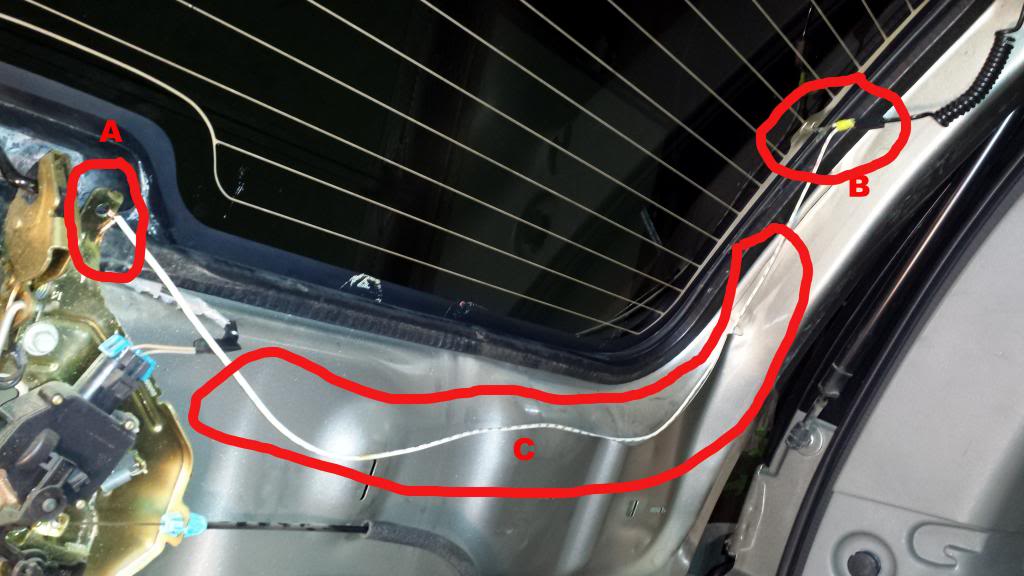

Or just like in this post its all just a bad ground? I'm going to try this put a wire from the wiper motor the the door, that seem to fix the problem for many people here.

So because no one got to reply and needed a fix because it snowed today I ask my father if he could help me out. He ended up testing a bunch of things but the main thing is that with a regular light bulb tester the lines had 12V all the time with the defroster on, still they didn't heat up. He ended up telling me to add a wire to the driver side cable and run it to the frame of the door so this is what I ended up doing.
Defroster works perfectly now but still the rear wiper doesn't work. He said its a bad motor that I need to get it replaced so that's what I'm going to do.
