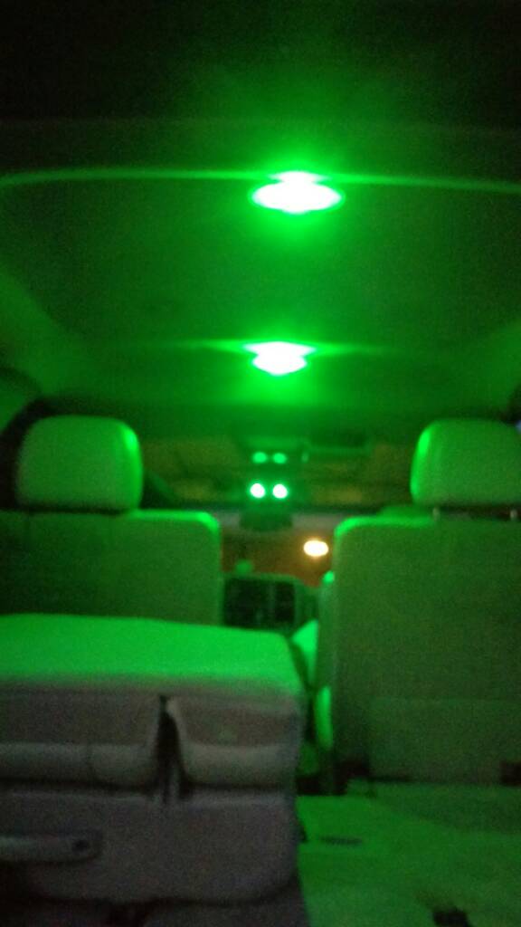

I don't know numbers or anything, but a friend said he's got me a set of green Leds to swap out all of the interior lights. Will post up part #s, where they came from, how it goes, and pictures when we get them in.
Sent from my HTC One M9 using Tapatalk

The set I got came with two pairs of different lights for the map lights. One had a bigger plastic base and didn't work with the little reflector piece. But they are super bright even without the reflector piece in there!
