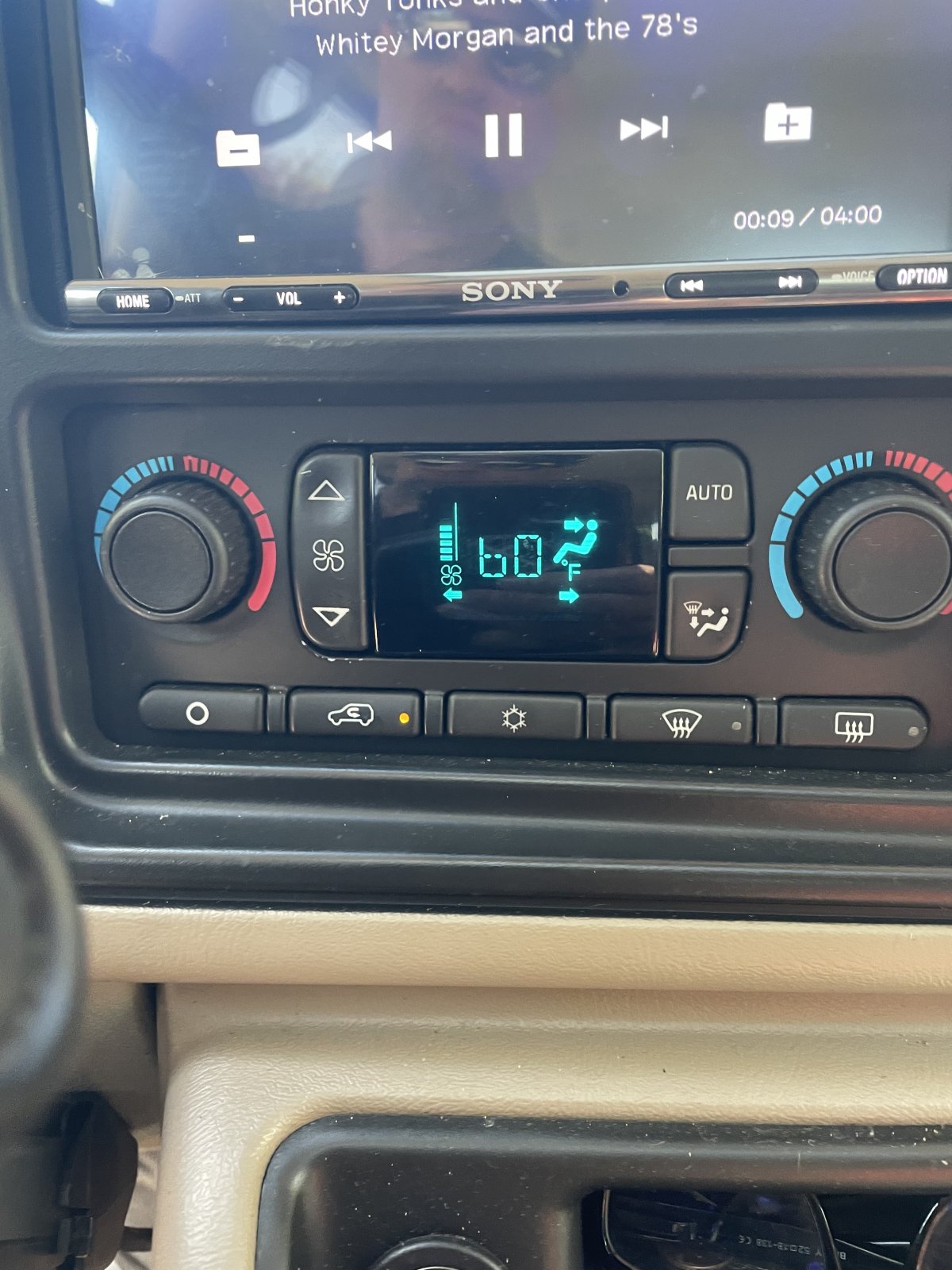

So I just serviced my AC. Needed a new relay switch for the compressor and a few pumps from the can. Blows cold. Only issue is, when I press the snowflake, no cold. But then I hit the recirculate and the snowflake disappears, and blows cold. I took a picture. Seems when the snowflake appears, the light should come on and blow cold. Only blows cold when recirculating.

I ran into this many years ago with my suburban and wife's Tahoe
But my 03 suburban you have to have the snowflake on for ac to work and on the 04 Tahoe turning it on, will turn the ac off. If you look closely you'll see a line through the snow flake where it means off
And if I remember correctly cause it has been many years lol. Something about the early models/ software automatically had ac off and you had to command it on. But then they changed it too ac was always on with the control and you had to command it off instead if you didn't want it.

What you explain seems right to me.
Also... I believe the Body Control Module (BCM) monitors and controls the AC, so swapping the HVAC control module in the dash to an aftermarket replacement would need a recalibration but should function the same as an original controller.

There are some variations as to how the A/C functions display, so it might be good to read the manual. Here's part of what mine says (there's more on the subject):

I understand the recalibration, I have a scan tool that does that for me. But the snowflake works opposite in between those 2 rigs I own
The snowflake actually has a line through it. When activated, you’re turning OFF the A/C.
After reading the other responses, I’ll also point out, my rig is an ‘03 as well. I’d expect it to match the behavior of your Tahoe.
