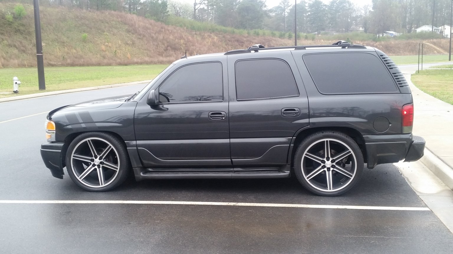

this is how it used to look on 2/3 setup but never really measured the front but now im on 3/5 and have new 24 inch rims on the way for the summer

Sitting low in front. I bet you are measuring ground to fender lip less than 33".
Those Iroc wheels did look nice. Interested to see what you put on for summer. And better with the bug guard gone. Looks good.

does ur hit the fender sometimes i had that problem with those but i did put new bumpstops and swaybar links that made a big difference with stock wheels and they wheels that i have for the summer are not out yet but they are paid for and im waiting on them from butler tire from rennen onyx

No have not hit the fenders how I am sitting.
Slight rub on full lock with front tires.
Rides pretty nice for being that low on 24s all things considered.

well with the new setup i hope i dont feel anything either im doing 295/35/24 this time might make a difference
