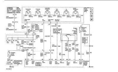

See if you can test continuity of c2-10 to A5 white wire
