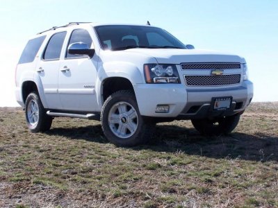

Zed 71
Sep 30, 2009
1,229
12
Pacific NW
Awesome, post some pics when done! Yeah, to fit anything bigger than 33s some trimming will be needed.
Since everyone is showing there level kit, here is a picture of my Z71. I need new tires soon...
