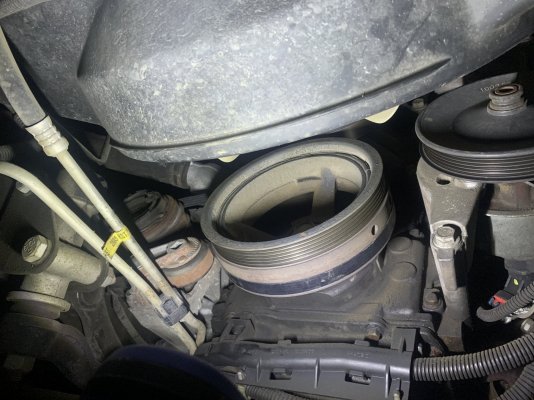

So since I bought this 01 Yukon XL 4x4 5.3 it’s had NO ac. so far I’ve done the belt and relay just to realize the Clutch is toast pictured below I’ve done some light diagnostics the clutch is spinning freely so I’m pretty sure the compressor is working as it should I have a China compressor clutch on the way to see if that’s the problem, any suggestions besides just take it to a mechanic would be awesome I wanna go back to off-roading and not dying on these 110* days with no AC

If im understanding your post correctly you have NO A/C whatsoever front nor rear? The clutch should spin freely if it isnt engaged. The clutch only turns the compressor if it is ENGAGED and at that point you would be trying to turn the whole engine with accessories over by hand if it were. The A/C system has a low pressure switch that actuates around 30 Psi and that is there to prevent a compressor from operating with no refrigerant or oil that is mixed with it that lubes the compressor. If that switch detects the low side refrigerant line below 30psi it tells the BCM to NOT allow the compressor clutch to be engaged. Basically in that case you would have a refrigerant leak that needs to be found and fixed and then vac the system down after a recovery of any leftover refrigerant and then charged once leak checks are performed and passed with the system under vacuum. You need to get a set of gauges on the system to see what your pressure is at on the low side at the very least if not the high side too(they should be equalized with engine not running). First thing I would do is get a valve core tool and snug the valve cores in the low and high side service ports since they are one of the likeliest causes of a leak.

Rockola1971 is correct. Your system might have no or low refrigerant an can have a leak anywhere. Dont throw parts at it until proper order of diagnosis.
The parts I ordered were from YouTube “mechanics” recommendations I didn’t hear the relay clicking when the belt didn’t fix it so I tried pulling it and it just fell apart. So I replaced it the clutch was $30 so I said f it I have a $300 part limit before I make it the mechanics problem. So far I’m $80/300 the next step if the clutch doesn’t fix it is refrigerant levels . And if there’s a leak and I need a new compressor it’s probably gonna be a mechanic repair.
This repair project was supposed to just be a AC belt because the previous owner had it “diagnosed” before and got told it would just need a belt. Well low and behold belt didn’t do anything but $20 was worth the attempt $300 was about how much labor would be including diagnostics unless it takes much longer than predicted. If I can fix it under $1,200 then I just saved myself not having to wait for my car sitting at the mechanic and or pay as much.
