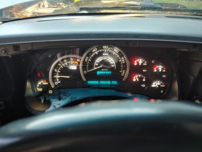

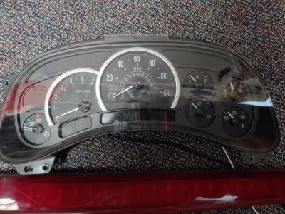

This isnt for my Burb or Hoe but for a friends 04 Z71 Tahoe, Picked up a spare Esky cluster among other things a few weeks ago from an Esky partout.
Friend said he wanted it but it wasn't in the best shape, bad stepper for the battery, PRND display was out and only a few lights worked. Swapped it to white LEDs,including turn signal indicators and cruise,a newer Esky style TRUE LED inlay from eBay, resoldered all the capacitors for the PRND and gave it fresh steppers, he is beyond excited to get it now
