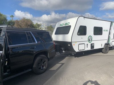

Not a Yukon, but I tow 6,400 pounds fully loaded, 30ft Travel Trailer with a 2017 Tahoe (5.3 engine) and I have plenty of power. I have a good WDH with sway control, so I get minimal way
Looks perfectly setup!
