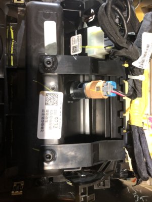

Here is the under side of how I did it. First I took the LC2i control apart. 2 screws.... then loosened the nut and removed the chip/LED/control. I used the face of the control housing to mark my holes and simply drilled them out. Once drilled and cleaned, I put the chip/control in place and used the nut to hold it in place from the front.

Next I took the punch control apart and used the face to make a template
Unit171
Sep 17, 2017
105
30
NC
With the punch control I had to use the housing and cut part of it down to use the face portion as a means to secure that chip and led in place. I simply drilled those holes and put that chip and cut down housing in place. Secured it with super glue initially then hot glue too for safe measure.
Unit171
Sep 17, 2017
105
30
NC
Lastly I had to cut some of the plastic that holds that cup area in place to allow room for the cable to plug in.
Unit171
Sep 17, 2017
105
30
NC
Everything is back in place and works/looks great. Took about the time for the Panthers to play the 2nd half of their game and win btw
Unit171
Sep 17, 2017
105
30
NC
Hope this helps someone feel more confident in drilling that new plastic!
