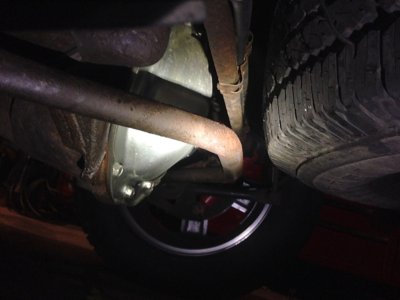

Did you try or are you guessing-i did some looking today-and see no reason it wont fit.Bridgestone dueler at 265-75r-16 is 30.6 diameter and my 275-60-20 duratrac 33 diameter.Looking under their it looks like it will fit no problem,I dont want a flat and have to use 4wd on a tire thats 2.5 inches smaller.Just didnt want to spend the money on a duratrac spare and 20 inch rim if it wouldnt fit.

Im going to get the same rim and tire combo i have on my other 4.It will be the most expensive spare combo i have ever bought,but i will feel better knowing i have the exact same tire and rim combo if i have catastrophic faliure.Im going to save a few bucks so might be a bit before i post but i will get it to fit-but it will be tight.No way a 35 will fit 00-06 body style your 16 must have alot more room.Or i would like to know what mod they did-maybe a pic if you got it.You cant cut the sway bar or hitch those are the only 2 things that make it tight.I just remeasured under their and i have 1/2 -3/4 of room towards the sway bar and 1.25-1.5 room toward the hitch.And it does look like you could cut some of the back of the receiver tube if needed without affecting towing.Im about a n inch short so we will see.

I put this in the suspension forum under sway bar but in case you didnt see it and were curious. Now the 33 inch spare tire will not fit without modifications.So i had to cut a small piece out of the hitch for it to go up in with out tire touching the track bar.So after the sawzall mod im calling it-no prob with the 33.
