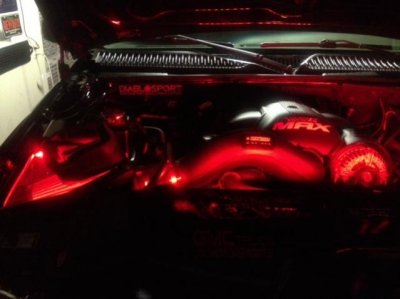

You could always do this in white ? just a thought. The red lights everything up im sure white would do even better.

How about the light from a NBS? I added LED strip lights and wired them into my factory light that comes on when I open the hood. Cost was less than $10 for the added lights, the original light can still be bought new.
img_6004-jpg.71463
img_6005-jpg.71464
