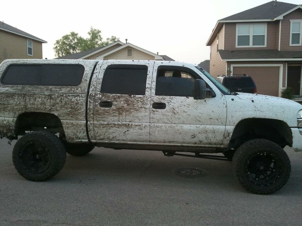

Old setup. Pre air bags, traction bars, and 37's. I decided to take my pocket flares off just a couple days before this. Getting in the mud was a sour of the moment thing.

Thank you, I will look into Yukon for lockers. Thank you for your help. I might go with 18s. What brand rims are your favorite? Out of curiosity.
Your truck looks very nice.
