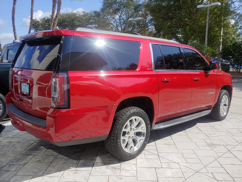

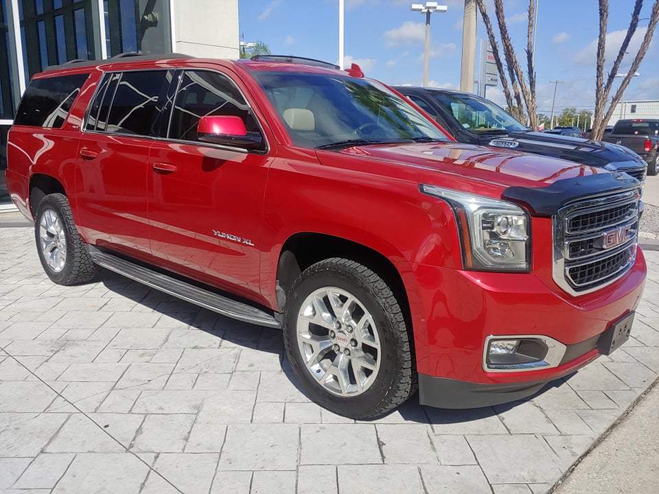

Here's a few pictures. Picked it up yesterday and drove it 180 miles home for the first trip with it. It runs and drives great, seems to have no issues other than the sunroof weather stripping on 1 side was hanging off. They told me to get it fixed locally and they'll pay the bill. Super comfortable and our 4 year old loved the dvd player. I rolled the dice and did not purchase a warranty for it. I didn't want to deal with aftermarket and since it was a Dodge dealer I bought it from I could not get it certified. Hopefully nothing major goes wrong!

Very nice. Welcome to Clown Town. You'll find a lot of people here know a lot about these things and are happy to help. Get that strip fixed quick, Especially in FL. A leaky roof will dampen your day for sure. "We'll pay the bill." :D:D:D Good luck. Hope its in writing.
