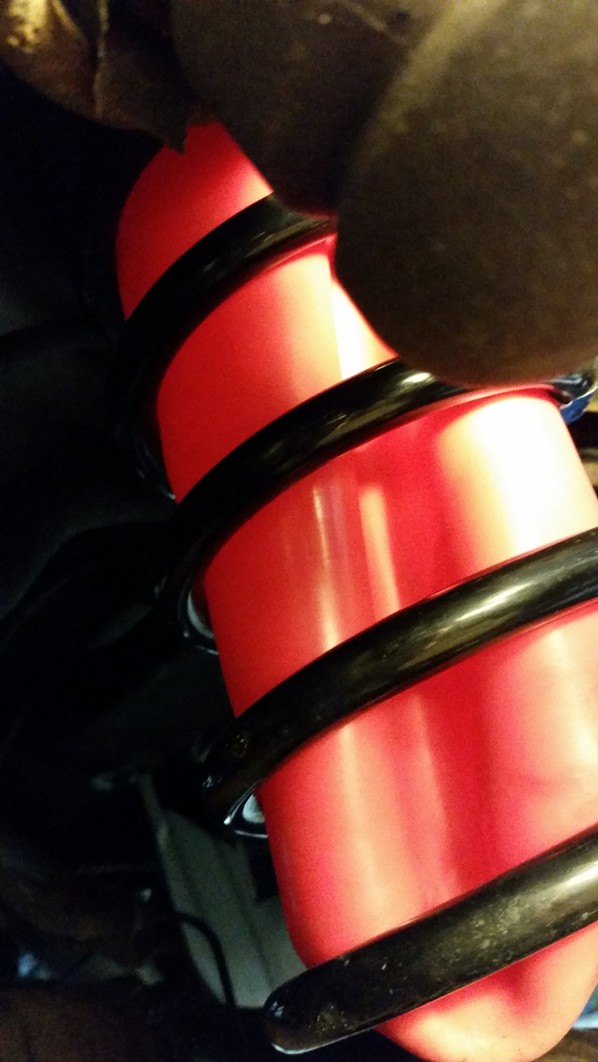

Ok, I received my Airlift 1000 bags (Part number 60769) from Amazon and attempted to install them tonight. After I fed the bag to through one of the lower spring openings, I attempted to inflate the bag but the it stayed collapsed (or folded) on itself. It will not completely expand inside the space of the coil spring. It stays partially compressed and folded inward as I add air to it. I've tried everything in an attempt to make the inward fold to expand outward. It's almost like these bags are too wide for the space. Did I order the correct size?

This is the best pic I can get of my noncompliant air bag. If I can't get the fold out, I'm not sure it would be safe to inflate under load. And it looks like the only way i'm going to remove it is to cut it out. Anyone have suggestions?

is your airline pinched.
I'm pretty sure NO as air I can air up and down with my compressor very easily. I've visually inspected the lines and nothing seams pinched.
also if your spring is about 4.9 inches inside diameter which it shoudl be you should be using the 60810. its 4.9 wide by 9 inches long and for stock springs
I have stock Yukon Denali coil springs on my 2009. RPO code listed for this truck is Z55 (autoride dampening and air leveling suspension). The springs are original. I'm not sure I have the correct Air Lift 1000 kit now that you mention it. I purchased kit 60769 off Amazon. I checked a couple of sites for proper application. I just did a search for PN 60810 and it looks as if they are for the Nissan Pathfinder. It seems that GM had quite a few variety of coil spring sets for these full size SUVs. Let me ask you, are the helper bags supposed to fit inside the spring loosely when not inflated? From the pics in your link, the answer is yes. I measured the inside width of my coil springs on the truck. it measures around 5". Probably 4.9 as I had a hard time getting precise on the tape measure as the spring is still mounted on the truck.
I'm going to remove the spring now from the rear axle and see if I can get the helper bag out and return the kit to Amazon.
