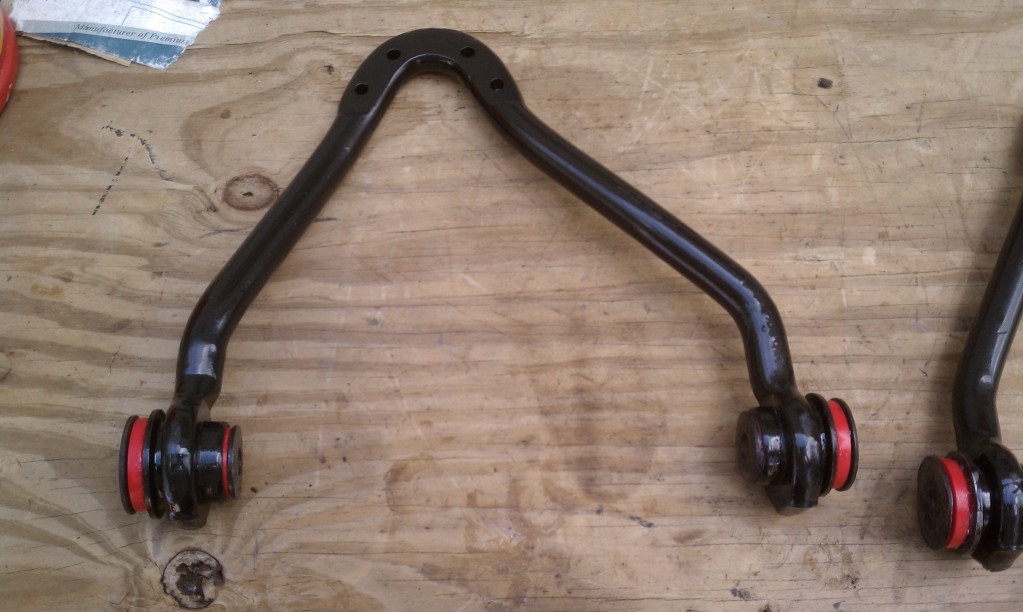

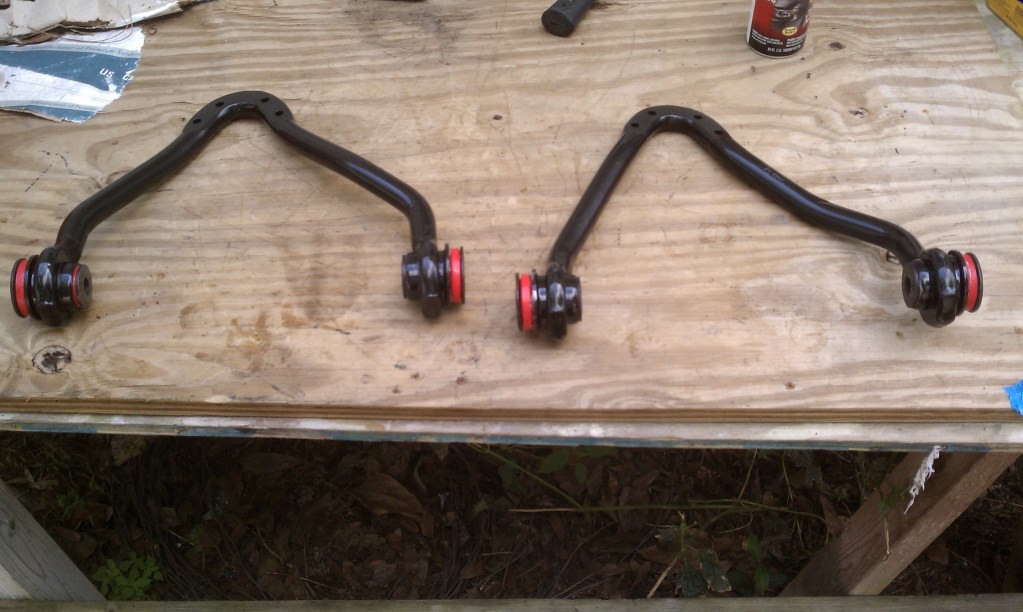

    My old single cab I put 2500 uppers on with 1500 balljoint, iirc one hole(of 4) needs to be opened up a little, the other three line up. Dont know about lowers
