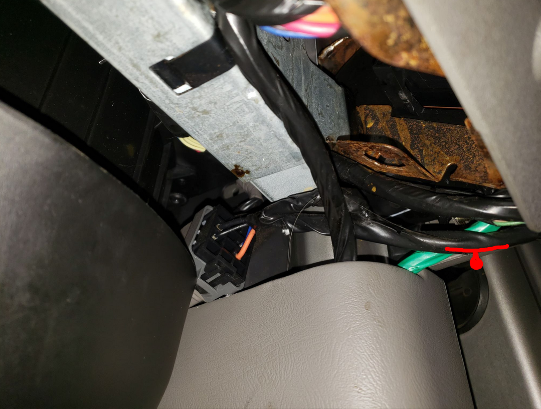

It drips down to one of the wires coming out from under the dash. See pic below: Looking up into the passenger side from footwell.
