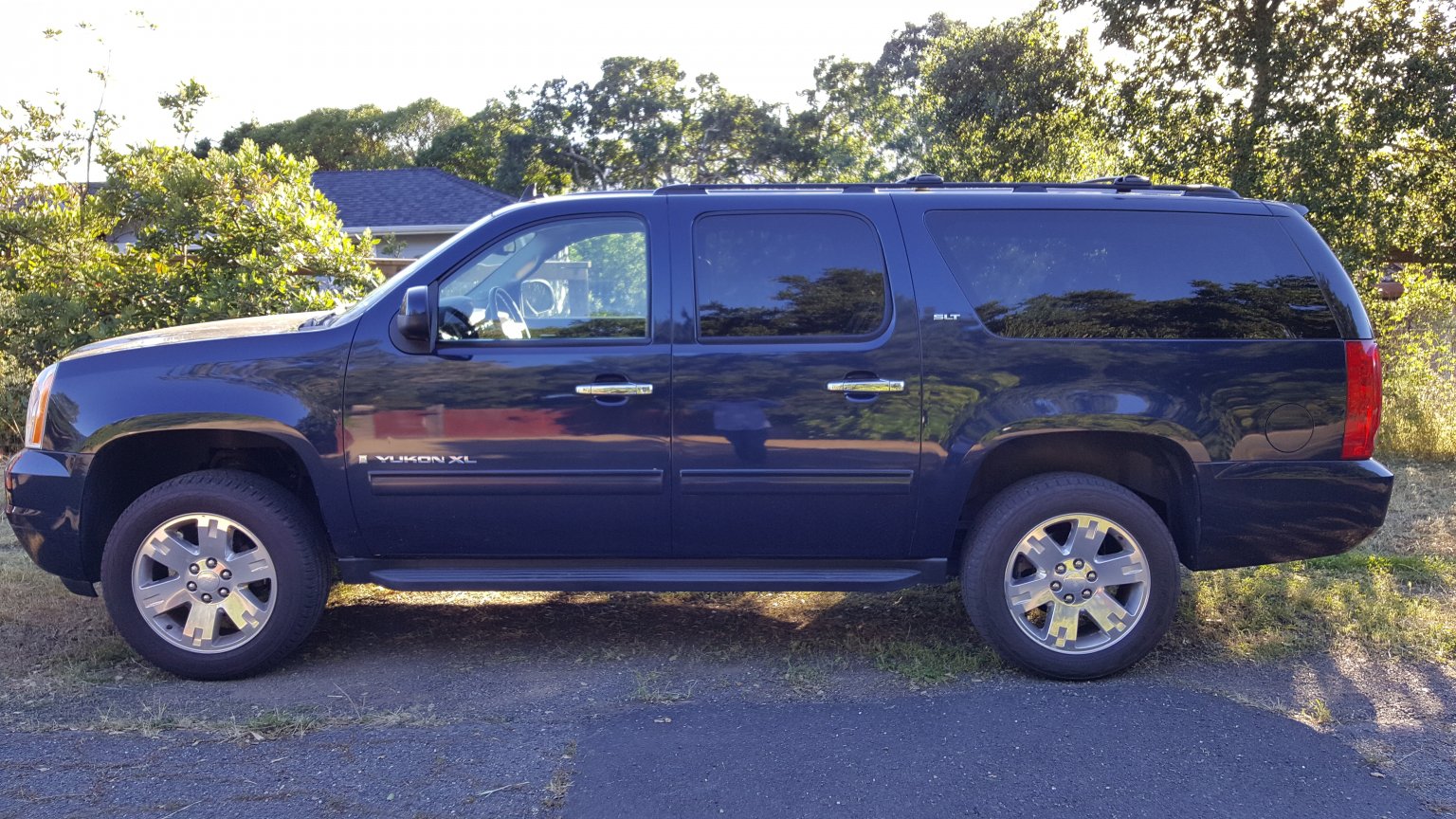

    Go CCM 2.5/1. It goes on top of the strut though for the front and under the spring in the rear. Looks like this.

    That looks good. I believe I am running 275/55/20 right now. Would that size tire still look ok or do I need to go a size bigger. This is my first truck with 20" rims. I am used to the old 285/75/16 wheels

    In the pic, the tires are 275/55/20's. I will likely go 275/60/20's next time.
