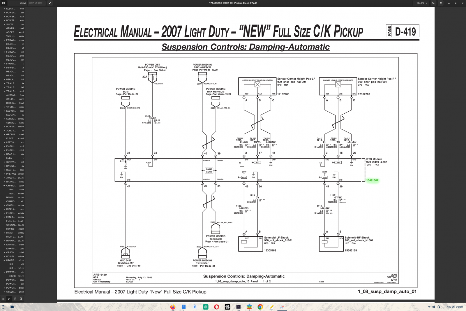

i have an autel maxisys mini with current , active subscription & updated as recent as today. it can pull all codes & perform all functions of the tech2 short of programming modules as i don’t have a j2453.
im getting codes C0575, C0590, C0585 - all but driver left damper actuator circuit open. i’ve checked all fuses, the relays, the ALC relay under the fuse box. i have a p200 power probe that can do all electronic stuff. i tested the relays with that. they are functioning.
the only thing i’m curious about is the possibility of a delete for the auto ride being installed prior to me. if so i can’t find it. i don’t have any codes for service ride control & never have. i should absolutely have had them since my suspension system was a rust encompassing facade made to look like a suspension system.
everything is brand new. i’m lost. help
when i active test - the dampeners get no reading.

Did you replace the electronic suspension control module? (located on the crossmember under the truck right above the spare tire)
3 of your 4 wheels are not providing an electrical path from the shocks to the electronic suspension control module, but it is unlikely that 3 of the 4 wheels are not responding due to 3 simultaneously broken wires along those paths. It is also unlikely that 3 of the 4 electrical connectors to the shocks are bad or disconnected, but check these connections, just to be sure.
It is possible, however, that the electrical connector to the electronic suspension control module is bad or dirty or damaged, and that is the next place that I would be looking. If the connector looks good, and you cleaned/reconnected it and still have the 3 error codes, then my next step would be to replaced the electronic suspension control module. When I replaced mine, it literally disintegrated in my hand after I removed the connecting bolts. No programming is required to replace the electronic suspension control module.
It is possible, however, that the electrical connector to the electronic suspension control module is bad or dirty or damaged, and that is the next place that I would be looking. If the connector looks good, and you cleaned/reconnected it and still have the 3 error codes, then my next step would be to replaced the electronic suspension control module. When I replaced mine, it literally disintegrated in my had after I remove the connecting bolts. No programming is required to replace the electronic suspension control module.
thank you for this. im hoping not to have to but if it comes to it... i will... its responding & communicating with my scan tool as normal & as it should. my gut keeps telling me there is an autoride delete on here. one shock was replaced as it was not factory when i pulled them from my truck. 3/4 were still factory - 1 not.. i mean the work done by PO. i have never gotten codes for ride control never got the message. my tool shows nothing of ride control, when i pull the 30 amp fuse 2 RTD with the battery connected & truck on - i get no "service ride control" on my dash DIC.. but i should. if you pull that fuse without the neg disconnected - it will always throw a message to service ride control. i have never seen that message & I aboslutely should have given the condition of my suspension system at the time i overhauled it. i am really at this point pulling my hair out & slamming my head on my rusty frame desperate to find out where my ride control communications are. i know i have ride control. but i dont. & i think in my gut this is the source of my issues. where is it!

well, if you cleaned it up and it looks ok, as in no signs of water intrusion, then clean the opposing harness connection also. dissconnect the battery ground, plug the module back in. reconnect the battery ground, then turn the key to the run position and you should hear the pump run, presuming all is well.
another thing to check is the pump relay it should be taped or strapped to the main harness just under the brake master cylinder area along the top edge of the frame where the main harness feeds up towards the fuse box, it is slightly larger than a standard relay and is usally beige/light tan color
