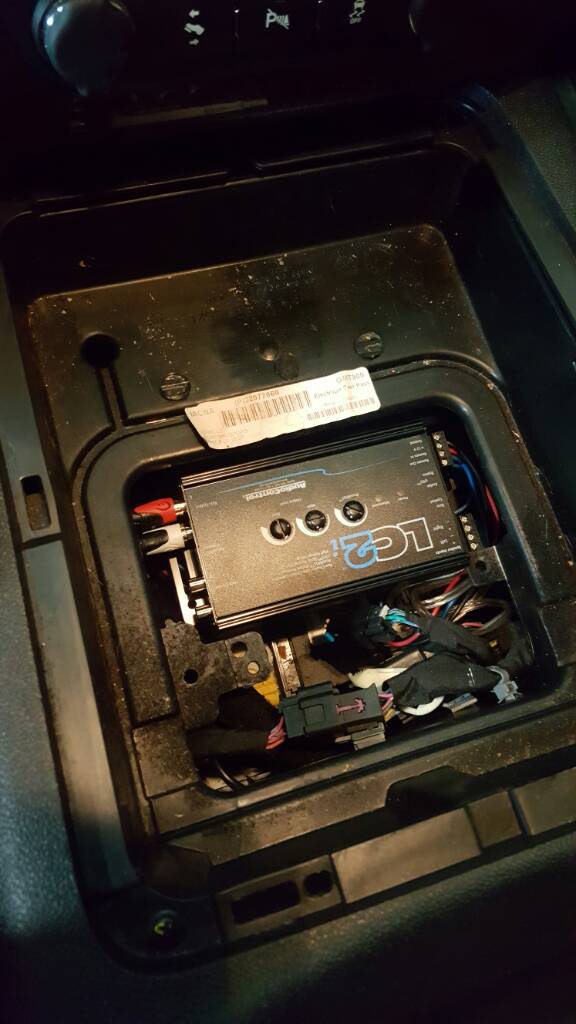

2014 Yukon Denali XL ... Here's what's happening every thing is fine till I close the door tia

Everything ran separately nothing goes through doors I've heard it could be the active noise cancelling anc just trying to figure this out so I can enjoy the extra bass . Every thing wire to center console to the lc2i

That's where I tapped the lc2i into .where did u tap for feed

I tapped into the subwoofer lines under the cup holder and then found the remote wire by the trunk release handle on driver side.
