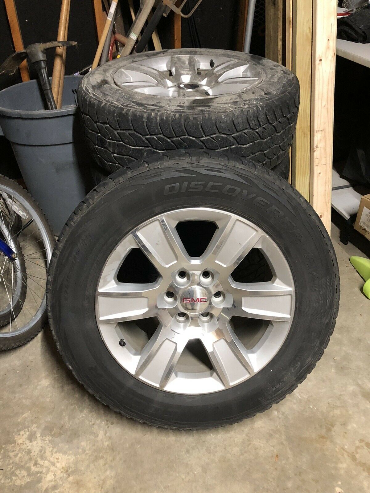

20" Sierra wheels on a NNBS
LRob
May 18, 2014
90
67
Does anyone have these on their truck? I'm thinking about going this route but have never seen these on our Tahoes. If you have a pic, please post up!

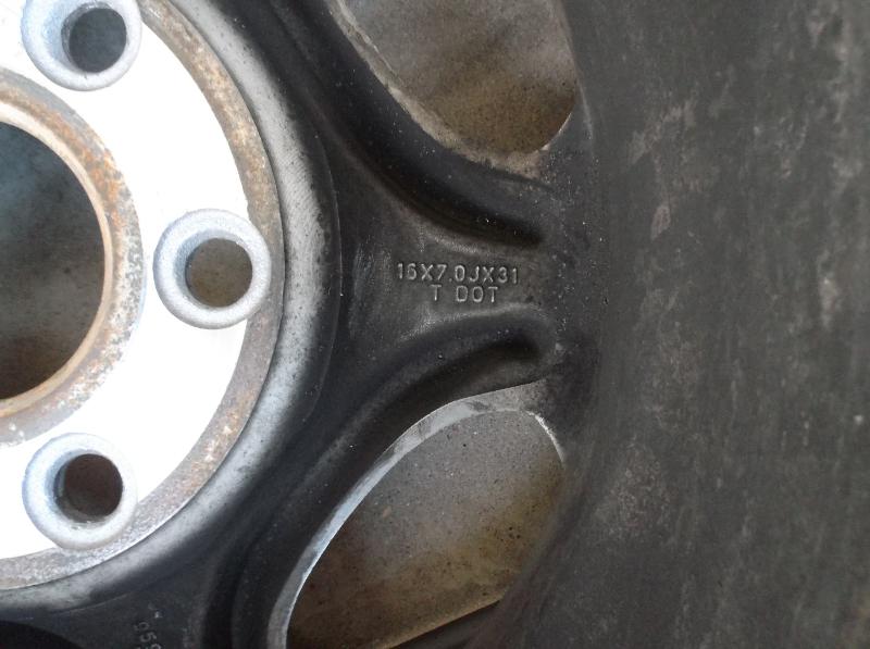

As @Fless stated, check the numbers stamped on the back of the wheel. The 'X**' portion of the numbers is the important number. If it is X31, then it is a 31mm offset, which is stock for the 20" wheels, and it should fit.

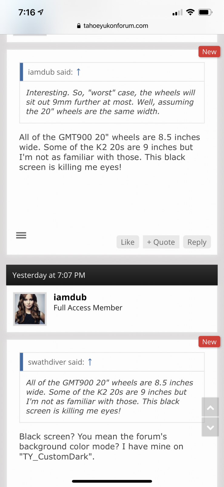

Interesting. So, "worst" case, the wheels will sit out 9mm further at most. Well, assuming the 20" wheels are the same width.
