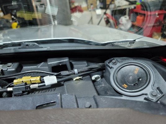

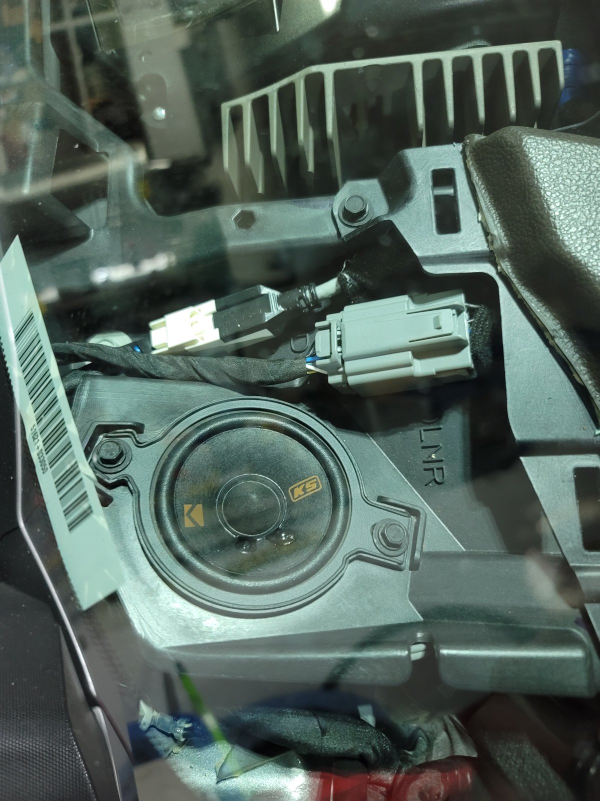

So I found a pretty decent solution. Try replacing your dash tweeters with the kicker ksc270s, and dont do anything else. They run about $65. Report back what you find...

Can you elaborate. How hard is it to change? Is it plug and play?
Plug n play mostly, but you do need to connect the wires. My speakers came with crimp connectors, or you could solder them - I actually used a new type of connector (shrink wrap meets solder) that just needs a lighter or heat gun.
As for the speakers, they arent much - very small and 4 ohm - but they have a heavier magnet plus little inline crossovers you attach to positive side. It fixes where Bose screwed up - like a cheat code. The factory corners get a full range signal but cant do any low range so they sound like shit and dominate the stage with harsh treble. By replacing them, every other speaker gets more power. Its exactly what most people expect in a Denali - much clearer sound with more bass. Not going to win competitions, but your music will sound much better.
If you want to add an amp, speakers and sub, you will be much louder, but you will also need to process the signal to balance the sound, and know what your doing. If you want people to hear you blocks away, this is the way. $1k+ vs $65 and all day vs an hour...
