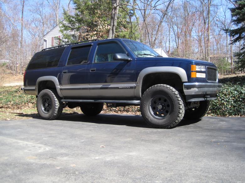

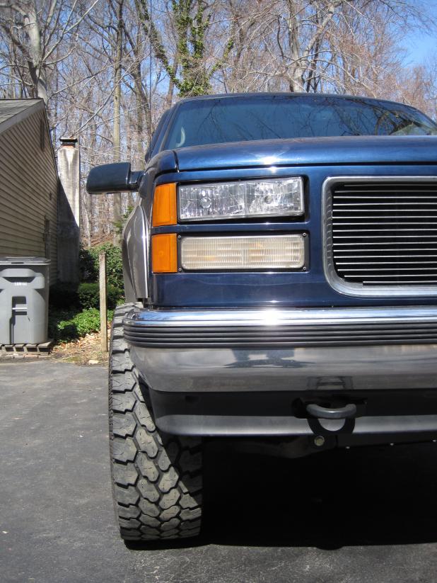

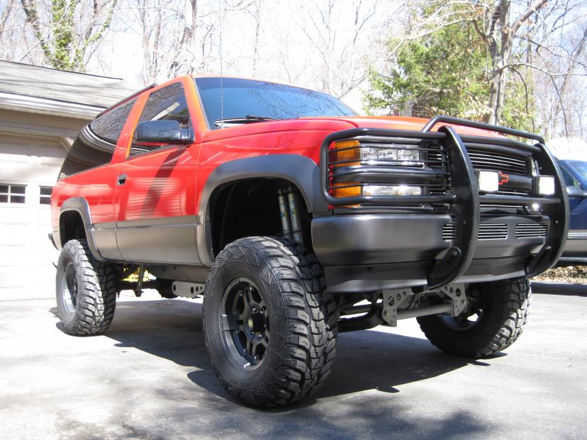

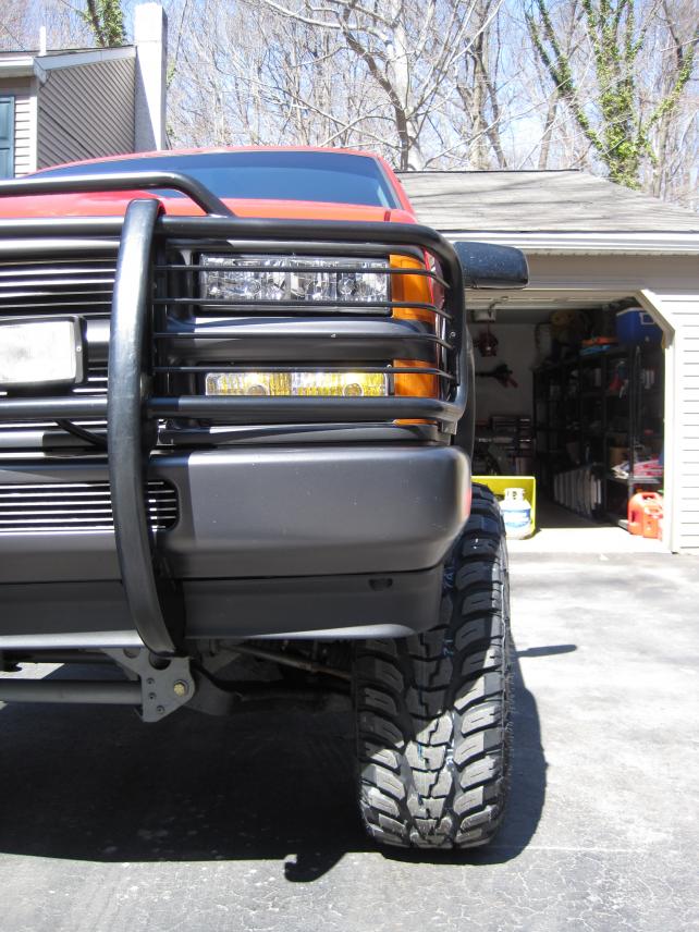

I run a 17x8 with 4.5" BS on the blue one and a 17x9 with 4.5" BS on the red one

looked it up. -12mm offset on the 17x9 on the red truck
0mm offset on teh blue truck with 17x8
