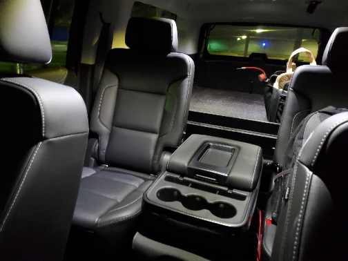

hey Avalanche did you ever try this?
I did. Used a silverado front jump seat and it fit nicely...
Sent from my SM-G975U using Tapatalk
K2 Kaiju
Feb 17, 2015
722
778
The Depths

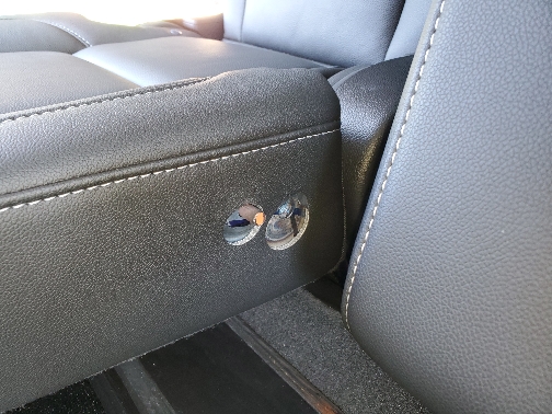

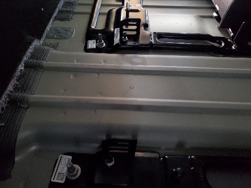

That does seem to fit nicely. Did you secure it using seat bolts and did it come with a seatbelt?
The seat mounts have holes that made it very easy to attach some seat mounting brackets. The seat did have an attached belt, and I added some rapid chargers for kids phones/tablets. I had to remove armrests, and ended up doing a 3d printed bolt cover. Its really sweet...
