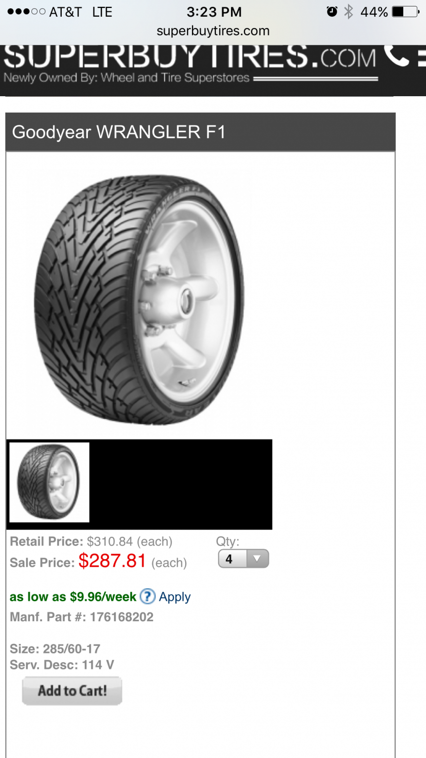

Good luck finding a 295/60/17...I haven't seen any online or local.
You're probably looking at a 285/60 (Toyo Proxes ST2 is the only one that I've seen making this size) or a 275/60 (Toyo and several others make this size) if you're looking to stay in a wide 60 series ratio tire.
What brand 286/60 are your running now?
If you go with an 18" wheel you'll have a lot more tire fitment options (sport and offroad look)...just a matter of how big you can/want to go. A 285/60/18 setup will be just under 32"...not sure if this is what you're looking for given the "stock-PPV" setup you've described.
