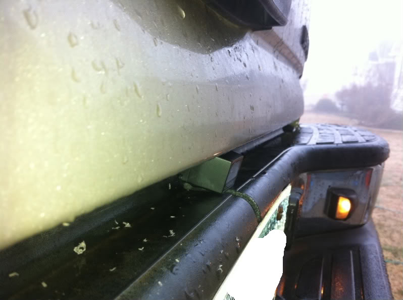

i have mine in the 1" gap between the bumper cover and the bottom of the door. it is tucked about 1/8" in so it hardly ever gets rain on it. it is also very hidden and clean. i have it at an angle and it sees my trailer hitch perfect and all of the road that i need for backing up.

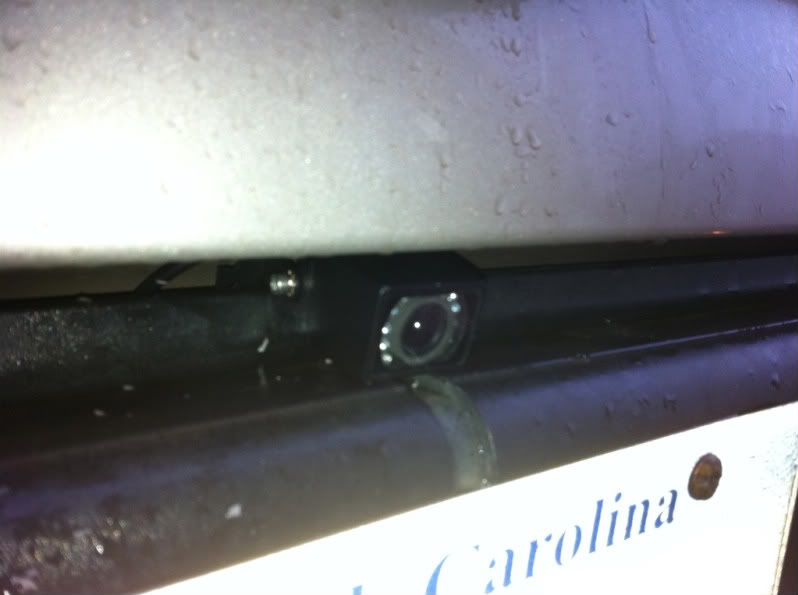

I installed mine in the same location between the center of the bumper and the door. I used an Esky EC170-11 that was $20 on Amazon. Installation was pretty easy since I was able to pick up 12V power for the reverse trigger from the back of the trailer wiring socket just below the mounting point. No need to run a wire up to splice into the tail light housing.
(Please pardon the salt, but it's winter in New England here.)
