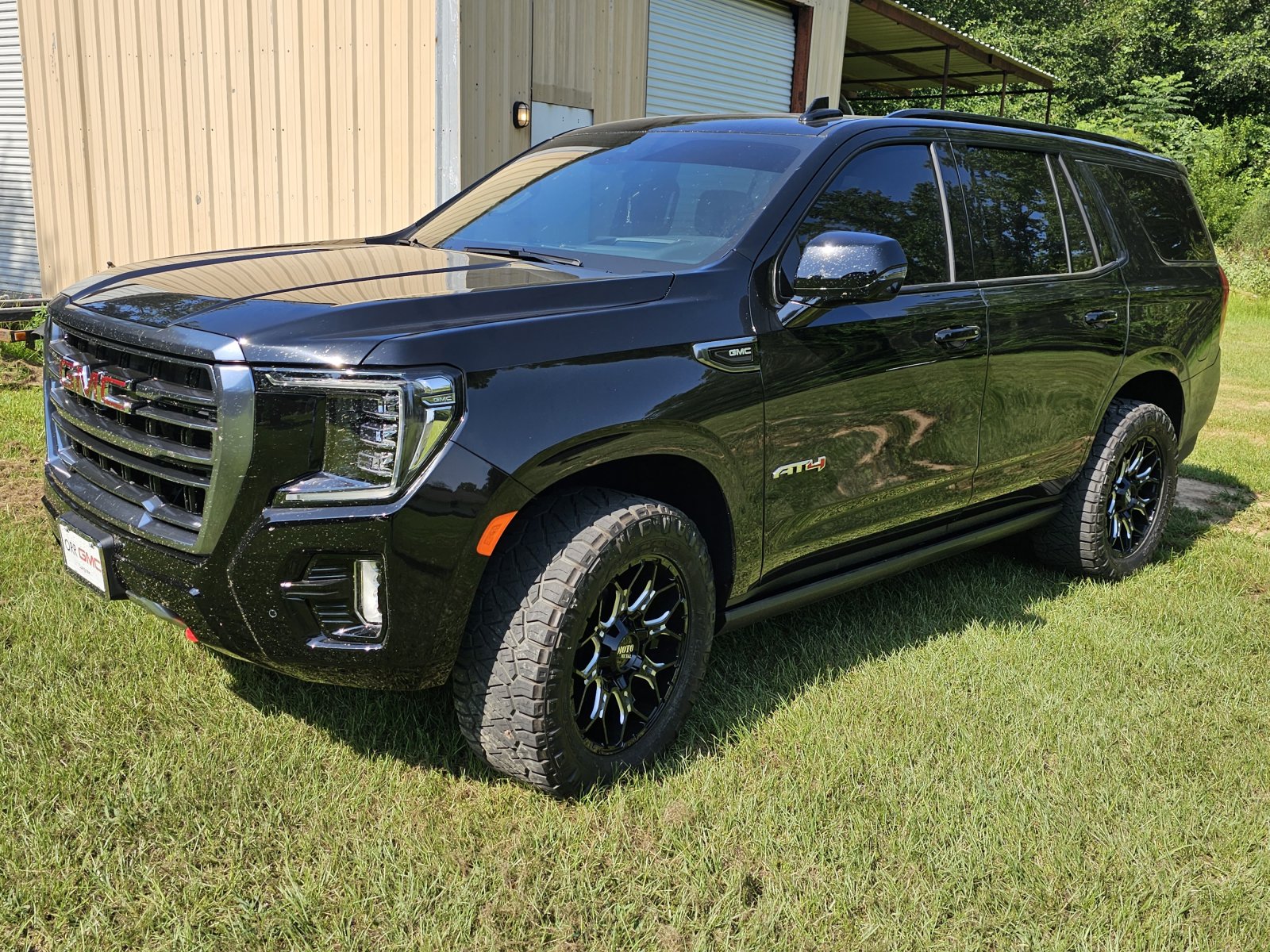

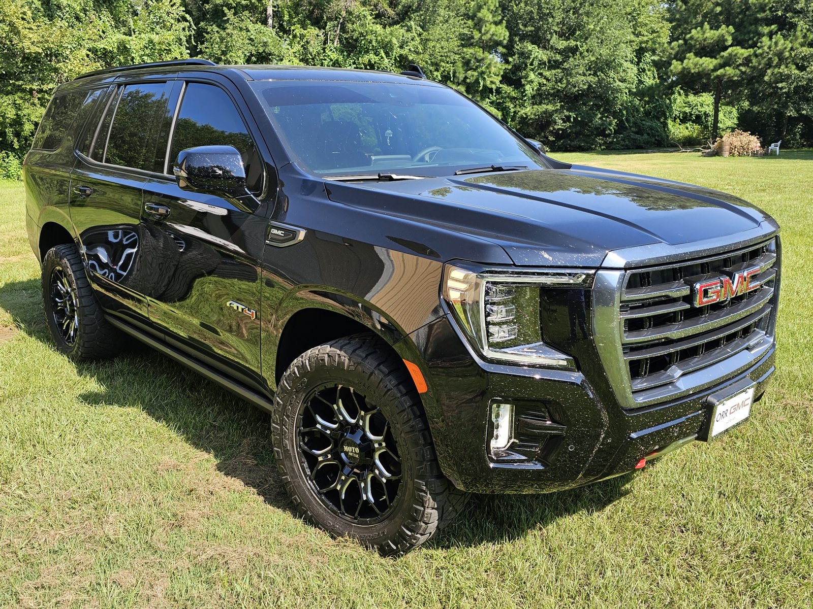

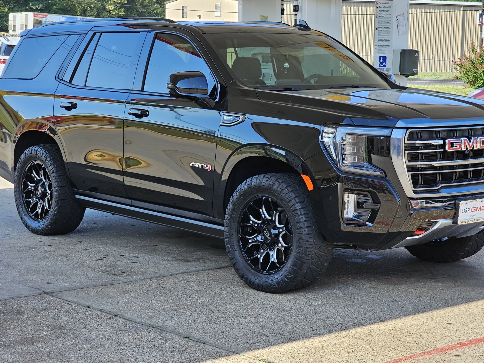

The final product. Ended up doing 305/55R20 on 20x9 with 0-offset. Minor fender trimming. Happy with the outcome.
Can you take pictures of how they trimmed the front? I have 20x9 +1mm offset with the stock 33x10.8's and have a slight rub at full lock on drivers side even with a 3 inch readylift.

I really doubt it was minor trimming. In my case, the frame extension bracket on the back of the wheel and the bumper support bracket in the front have to be modified or removed.
