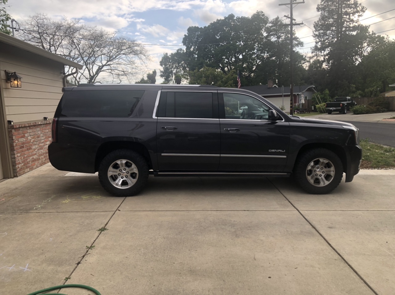

2007 Yukon XL Denali - 305/50x20 on 20x8.5" 31mm OEM rims with stock height and no rubbing.

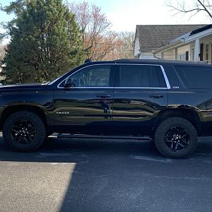

I have 275/65/R18 tires and factory Trail Boss wheels with no rubbing. I do not have a leveling kit (yet).

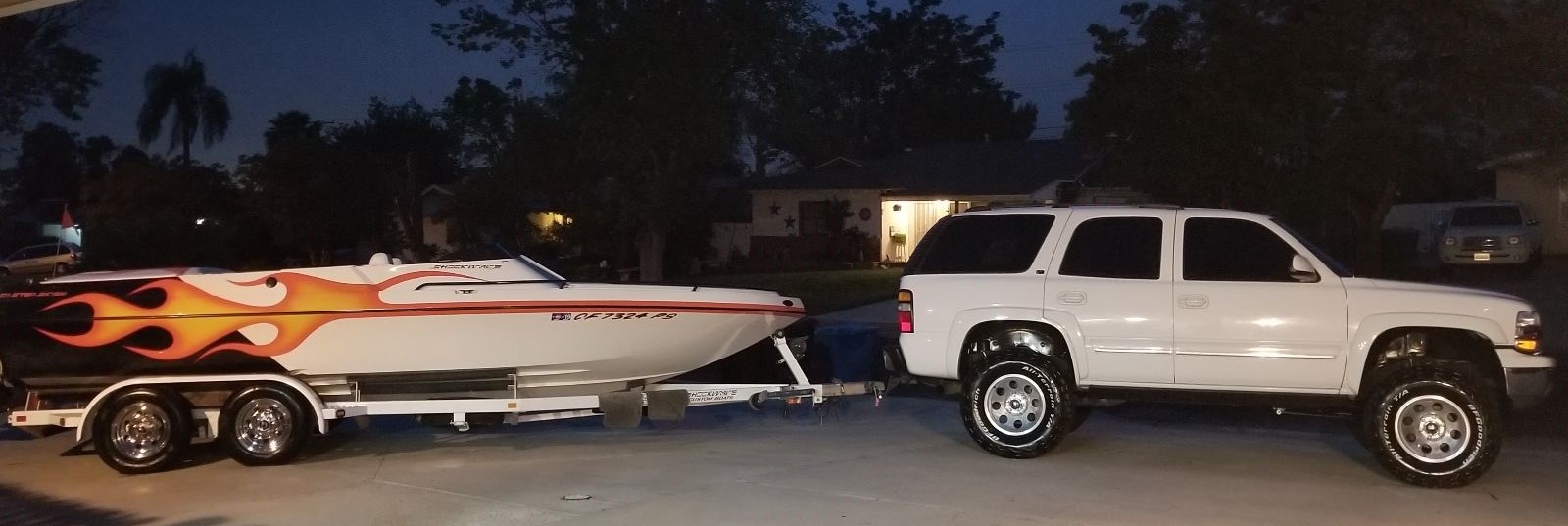

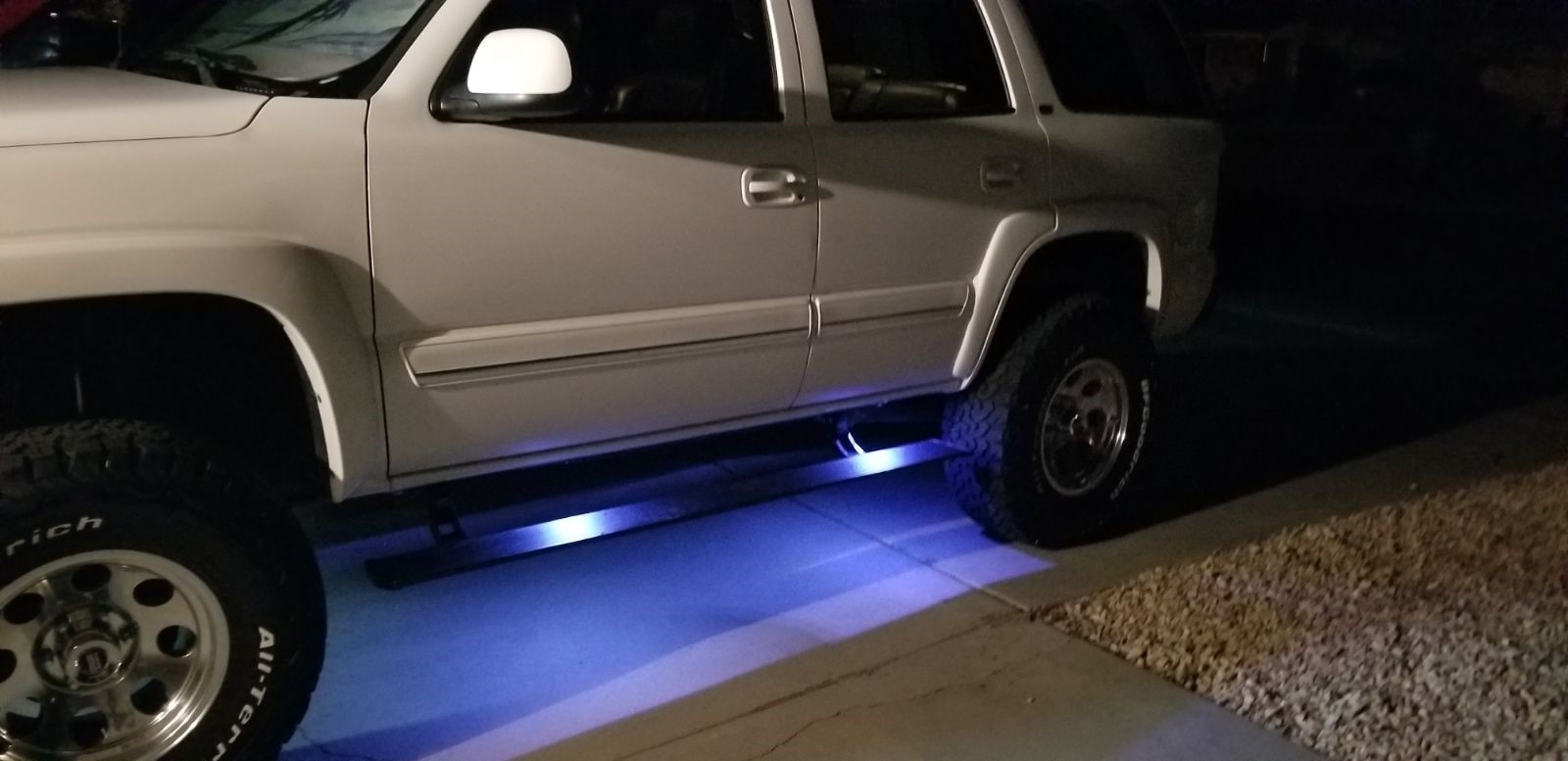

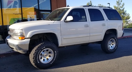

6 inch Rough Country lift with 35 x 12.5 x 17. The lift called for a back spacing of 4 and a half inches on the wheels (and a 2 inch spacer in the rear on both sides to even out the width). That is what I went with on the American Racing Wheels. I did have to cut the plastic at the back of the fender well in the front and the tires would barely rub at full lock at the very bottom inside of the fender well. Luckily it was underneath and a few taps with s sledge hammer pushed the metal out of the way. I had a little more room to lift the front but I also didn't want to go full crank on it and really mess up the ride. Overall happy with it and gets a lot of compliments for being 15 years old. I do believe most lift or lower kits specify what you can and should run with them.

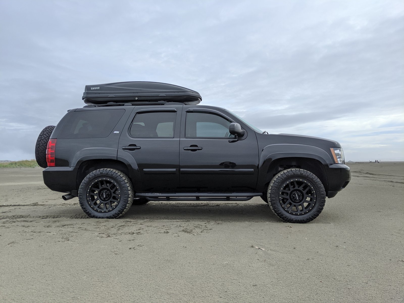

Fox 2.0 front/rear leveling shock kit. 2" Daystar spacer rear. Cognito UCA's. Method MR309 wheels 20x9, offset +18, Backspace 5.75. Nitto Ridge Grapplers 295/55/r20. Required trimming of the front portion of the front fender wells.
