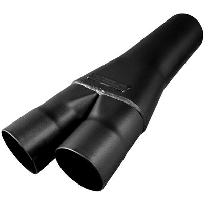

since your doing some work, have This installed as well. you will be glad you did. Its best flowing Y pipe merge available without going custom. $39.95

yep listen to ezdaar. mine came 1 in 2 out factory and yep it looks good. i doubt its expensive and will save alot of swearin trying to weld it up right

Thanks for the advice im gonna go with 2.5 all the way through and get that y pipe as well

That merge is a 2.5 to 3". If I was you I would run 3" all the way back.
Just makes sense if you have ANY plans for more mods down the road..
