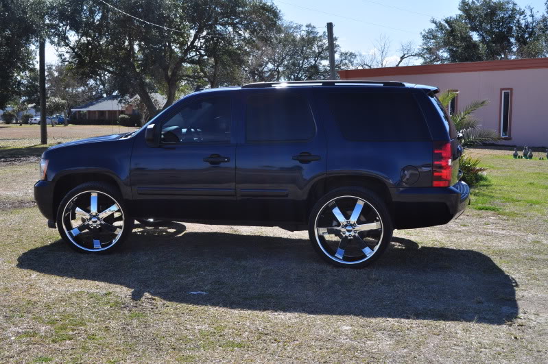

Haha I am kind of biased like Conor said, but you can compare my 2/4 dropped 24 pics below, to the 3/5 dropped on26 pics.
Pretty sure you can guess which is which:
Also a 315/40/26 is a huge tires, its pretty much 12" wide and 36" tall! You will need atleast a 6" lift to clear that one!:shocked:
If you want 24s for a stock height Tahoe, you need 305/35/24, then 295/35/24 if its dropped. Then 305/30/26 for a Tahoe with 26s.
