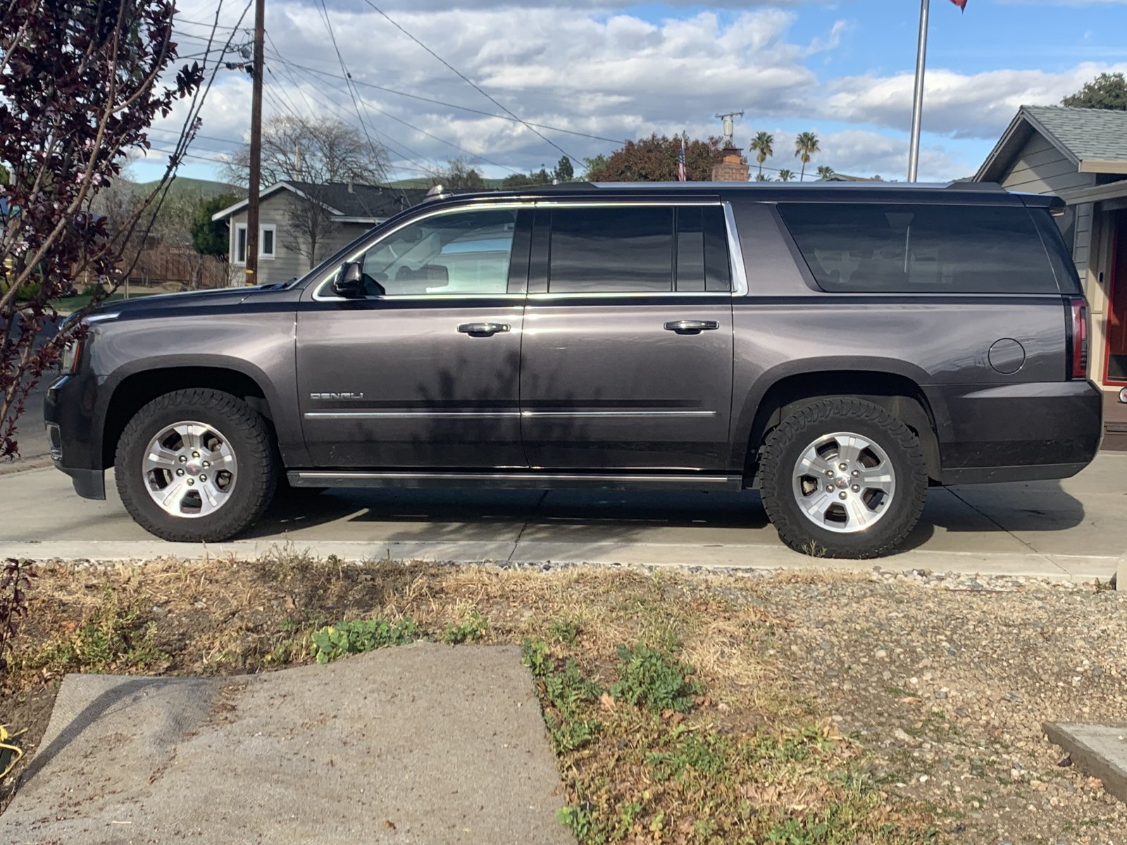

Well… the Arnott springs settled so much it got annoying. I think it got lower than stock.
And I only have 33k on the truck and maybe 2500 miles on the arnotts if that.
So I ordered the suspension maxx 1.5 inch level and I feared it would be too high.
Nope… if anything it’s still a hair lower than rear so it looks correct.

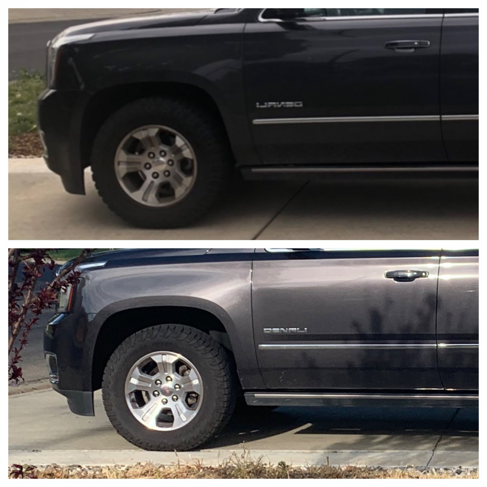

I wish I had taken a before pic. I know I have one I just need to find it

Before on top…
