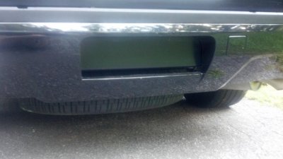

You lost me on this reply....you refer to a pump?, PIA?
The rear bumper cover has the same hole in it as a regular Tahoe just has a straight steel bumper instead of the receiver bumper you see on regular Tahoes.
I will post some pictures.

Rear bumper of PPV
Here is a picture....first time to post picture hope it works.
