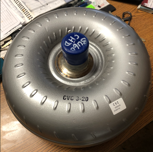

So, the shop I'm working with suggested a TC overhauled by CVC. They're a remanufacturer who's apparently known for their upgrades to the stock units to make them more durable, including a heavy duty billet front, dual-plate clutch lock-up mechanism with upgraded friction materials, and a flanged hub. He likes them because he's had good experiences with their units over many years, and believes it's a quality upgrade that will support the towing I have planned. The unit will run about $500, shipped, which is also good. I think I'm going to trust his advice and bite the billet :) I'll keep y'all posted on how it turns out.

Dropped off the truck at the transmission shop this morning. Got a shot of the new TC sitting on his desk. It's a heavy sumbitch. He had a stock one nearby that he had me pick up too, and it felt like it was half the weight. That billet cover on the other side is SOLID. He's gonna put in a Fel-Pro rear main seal and cover gasket while he's in there.

Sweet man. Seems like a solid deal for you!
Are you going with the factory stall rating or did you bump it up?
Went with factory stall, but with that Stage 2 cam in there maybe I should've gone higher?
With a stage 2 you should be alright.
I will tell you, with the Stage 3 you definitely a 3-3200 stage. I did my cam first, drove it.....and was like ****, need a stall now LOL. Had nasty cam surge at stop signs and lights.
