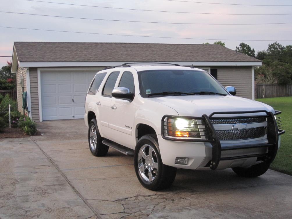

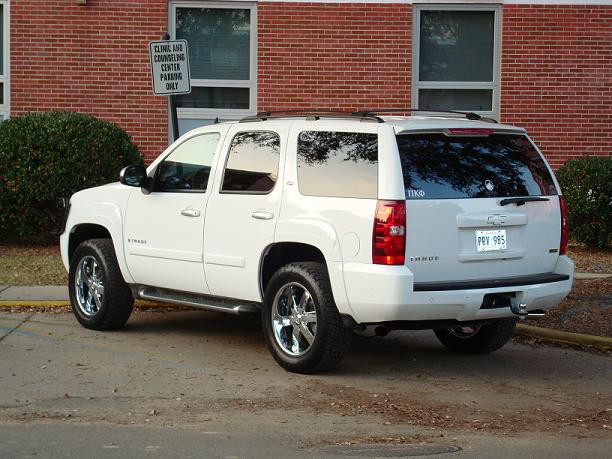

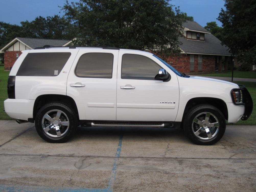

Here is mine before I added the CCM leveling Kit with 275/60R20 Tires. Now i have 305/55R20 with the leveling kit and I only had minimal trimming.
In these pics with the 275/60/20 tires...is that stock OEM susp?? Did the 275/60 rub al all? I am looking at installing a CCM 2.5"/1" on my stock 2007 Tahoe LTZ and want bigger tires, but DO NOT want to trim anything.... Thanks for all/any info.
