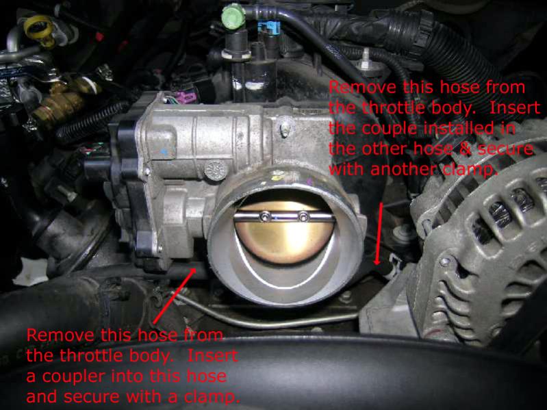

I found this over at denalitrucks.com but figured I would share it with you guys. I first questioned the coolant lines on the lower part of our throttle bodies and the actual benefit of warm-up during the colder months when I cleaned my tb last week. Upon further research I found that plenty of people are deleting the coolant bypass through the tb to ease cleaning and keep the tb cooler (limited performance benefit). Another guy was kind enough to post these diagrams to better illustrate the modification

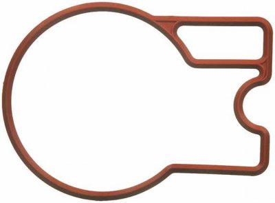

I had plenty of slack in the line so I just removed the smaller coolant hose toward the driver's side, now it is 10x easier to clean the throttle body when you don't have to disconnect the coolant lines, don't forget to buy a new gasket for the throttle body they're about $7 from your local napa part # 61070

I just did this mod. Not nearly as easy as it sounds, but I got it done nonetheless. Haven't noticed any benefits from it quite yet since it's cold outside, but summer is right around the corner...
One thing I will say though, is that the driver's side is a *****. More than likely, you will have to cut the rubber hose off at the metal barb, cut a slit in the remaining hose, and peel it off the tube. Thats ok though, theres plently of slack left in the other side for when you need to connect the two.

I did this as well.... what a pain in the ass. I had to climb into the engine bay (truck is lifted and I'm short as shit) to get to it all. Drivers side was a pain in the ass and it's where the coolant flows from. I lost a lot of coolant doing this. On a dyno, it was proven to give a solid 1HP difference. So...can you feel the difference? No. Was it really worth the time? Probably not. Was it still kinda fun to tinker around for an essentially free (if you dont buy the barb) mod? Hell yeah

Yeah, this was unexpectedly difficult. Them little barb clamps are a pain in the ass for sure. Overall easy though.

As I've stated before the mod isn't necessarily for power, it's more for ease of cleaning for the throttle body. There has to be a mild performance benefit, perhaps lower IATs. Took all of 5 minutes and it makes the throttle body much cleaner when coolant isn't running through all the time. Plenty of fools up north with the mod and no adverse effects during the winter.

X2... this is a smart mod to do for anyone who is into keeping their motor and its internals clean. I wasnt planning on doing the mod as i also thought it would be worthless, but as all of you who have either done the mod or cleaned the TB once know, these lines make the job far more dificult.
So bipass i did, and now i have no quams about pull the TB off every so often to give it a decent cleaning. only takes a few minutes now
