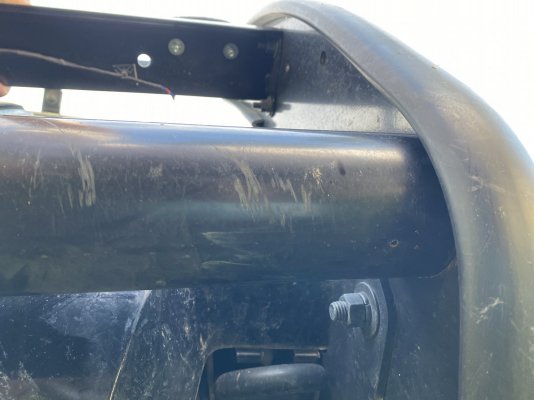

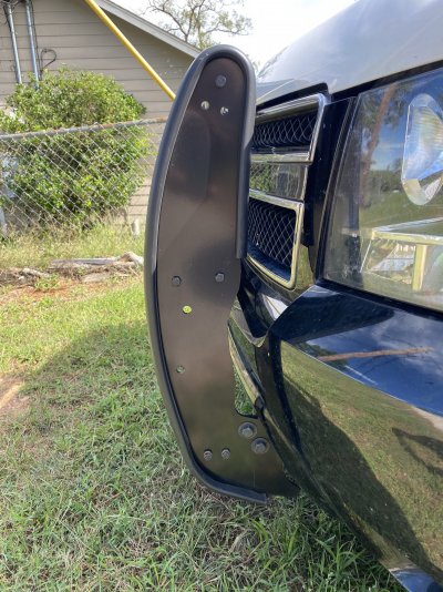

Update on thecopcar. it looks like the pushbar needs some drains added to the lower cross bar.

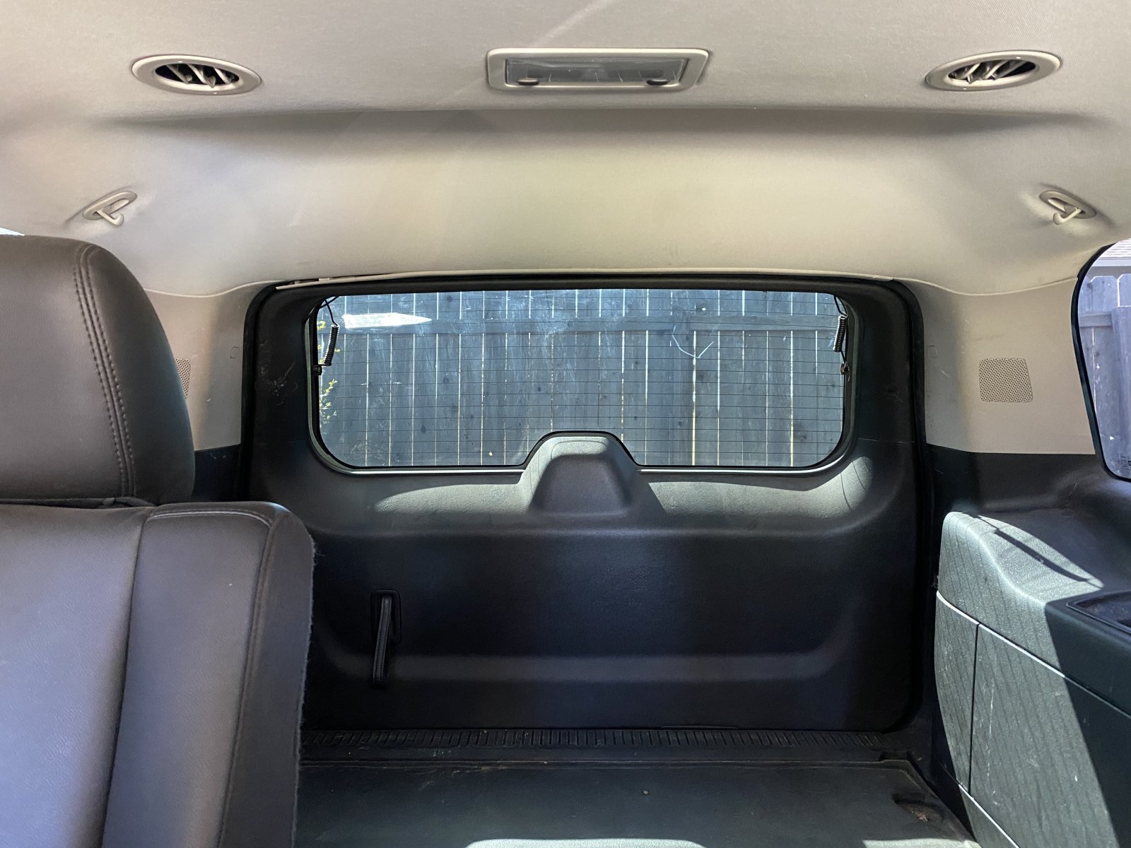

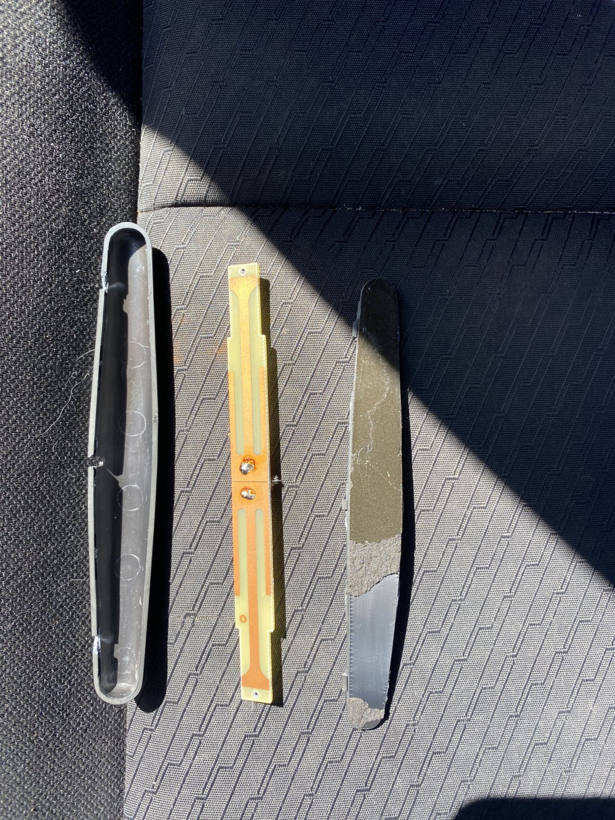

I’ve only had theothertwin for a year. I somehow missed the radar antenna on the windshield, hidden by the mirror and eyebrow tint.

Finding that antenna brings clarity to the torn tint on the rear window. For another antenna, of course. This explains the adhesive spot in the same place on thecopcar rear window.
Also, the tint as soooo dark, you have to really look to see the tear from outside.

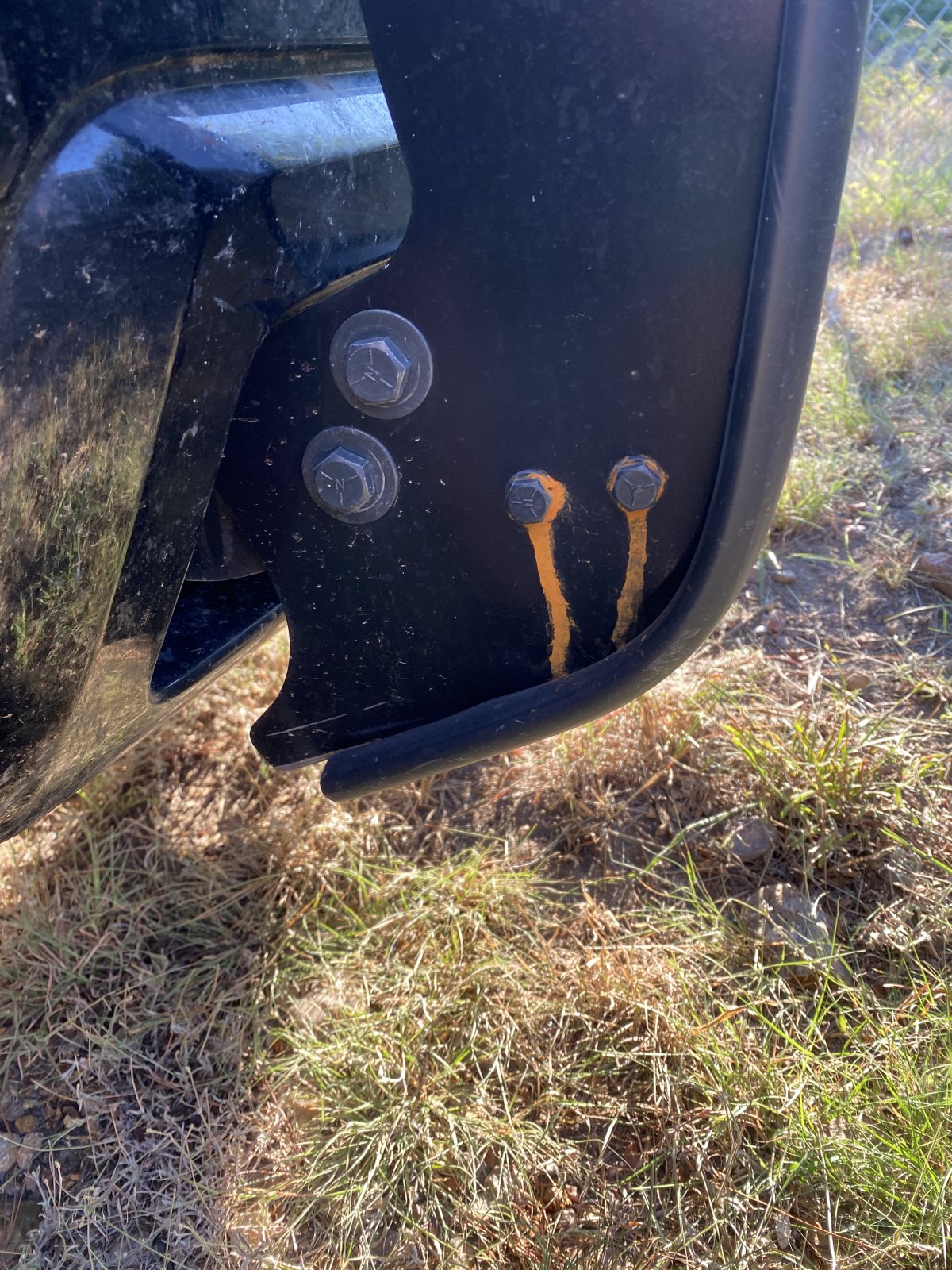

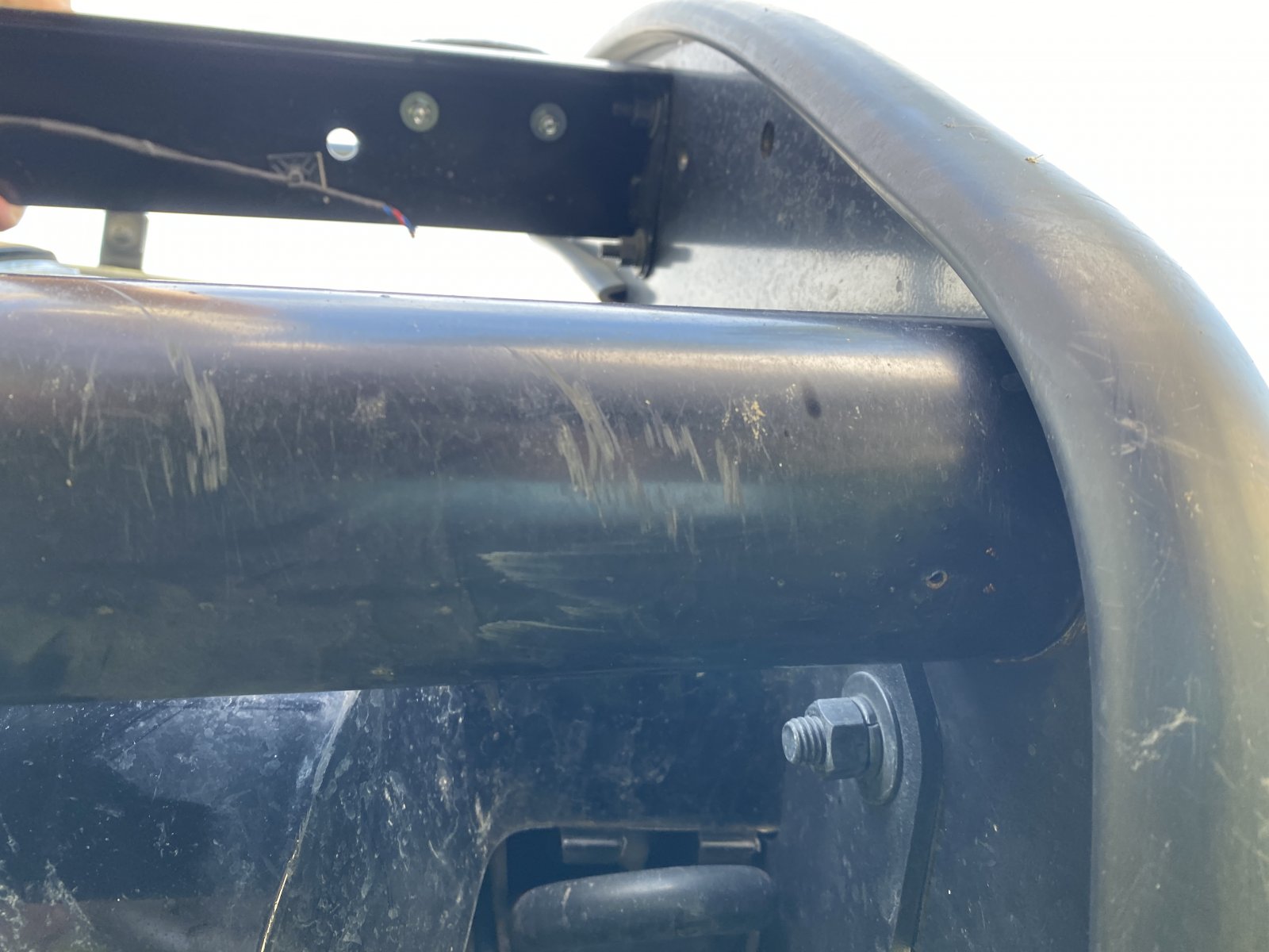

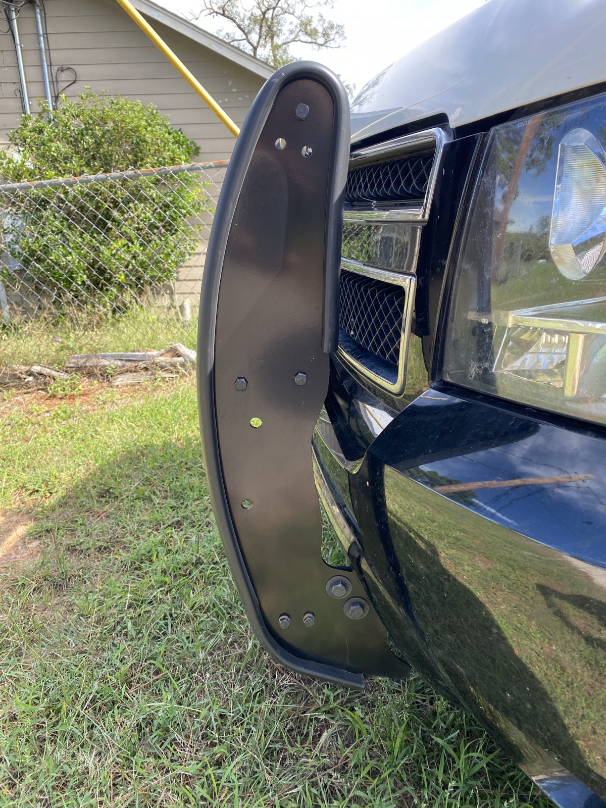

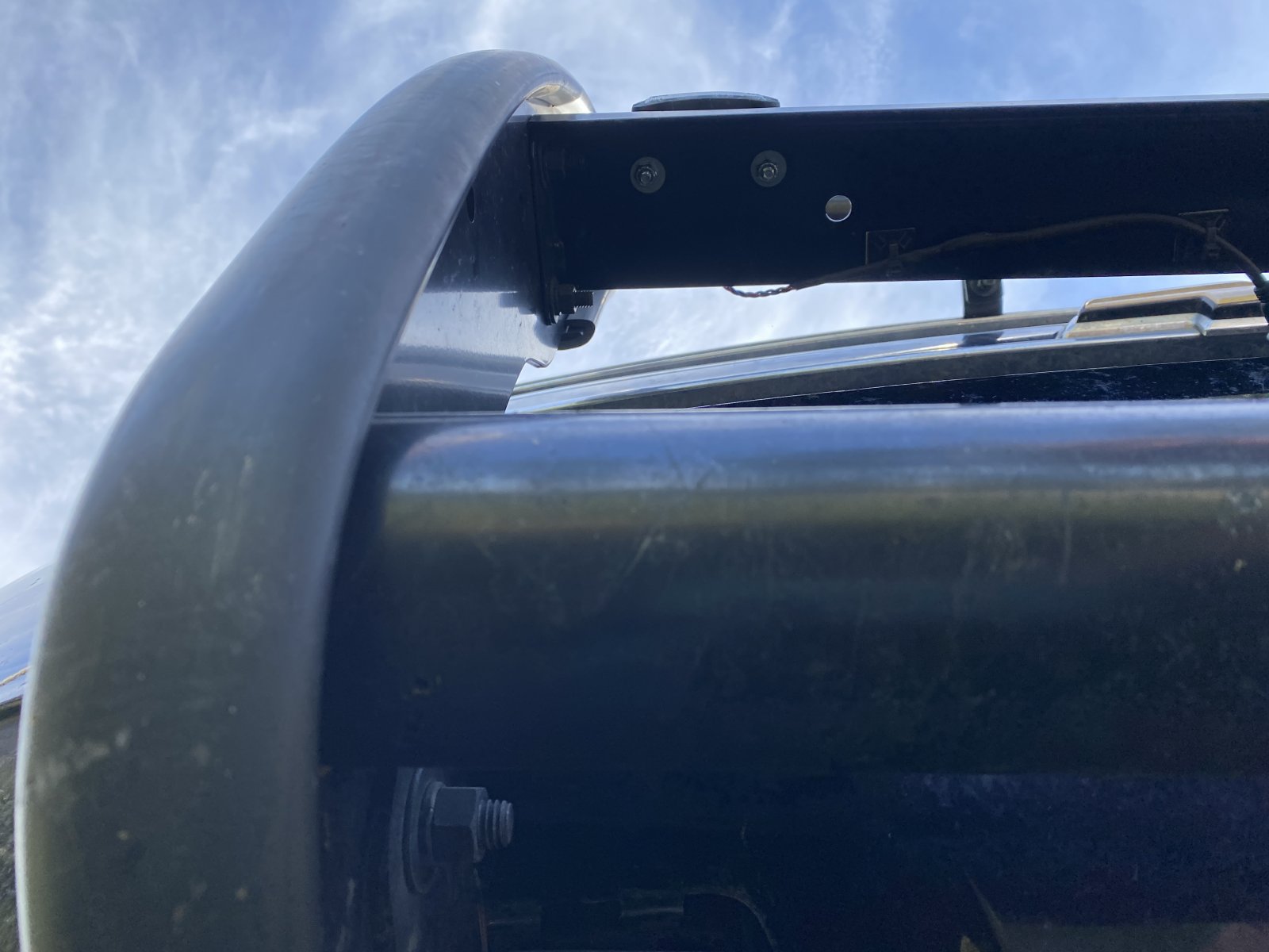

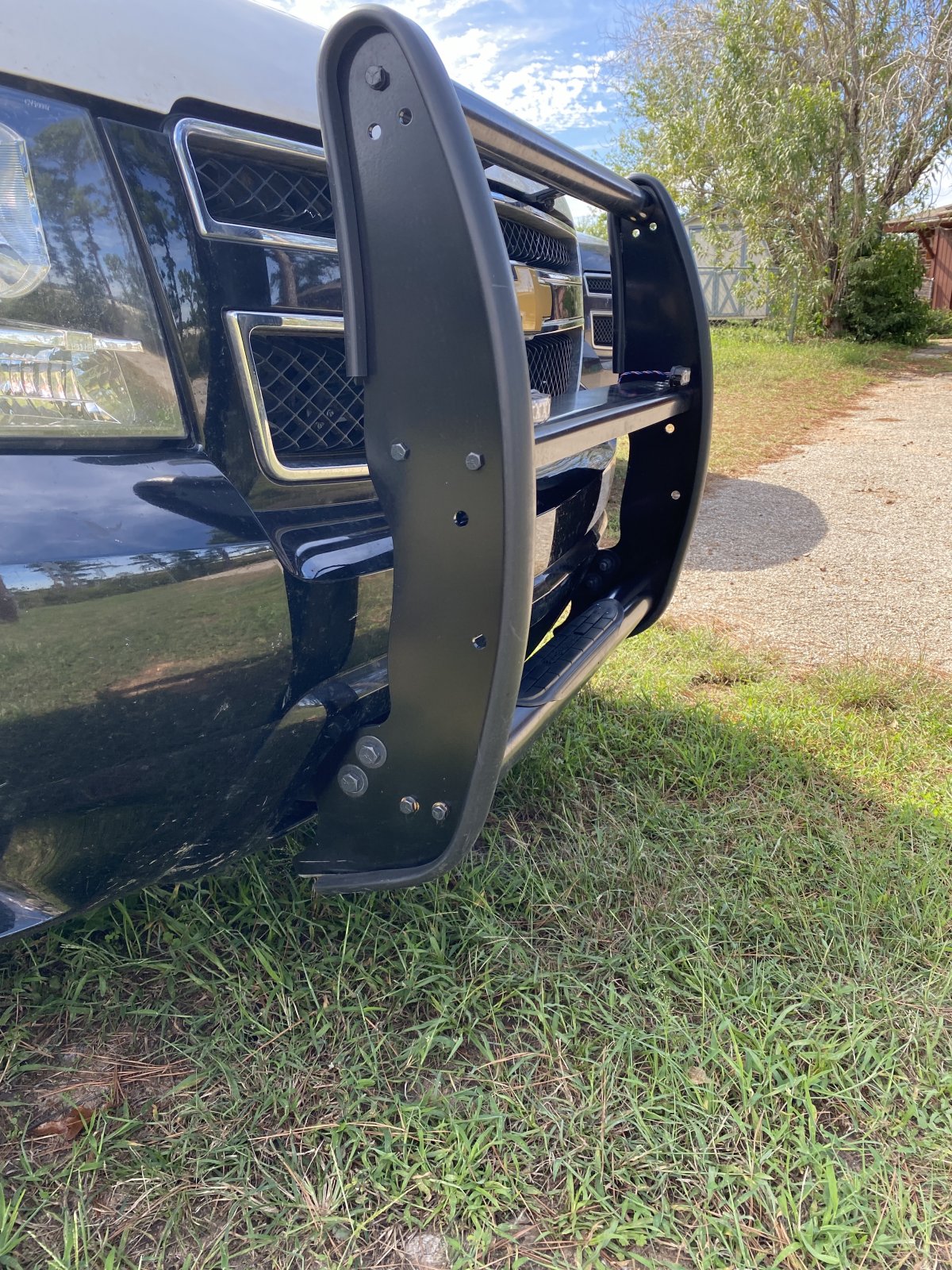

Another thecopcar update. The drain holes in the lower tube of the pushbar seem to have helped. We had 6” of rain overnight a couple of days ago.

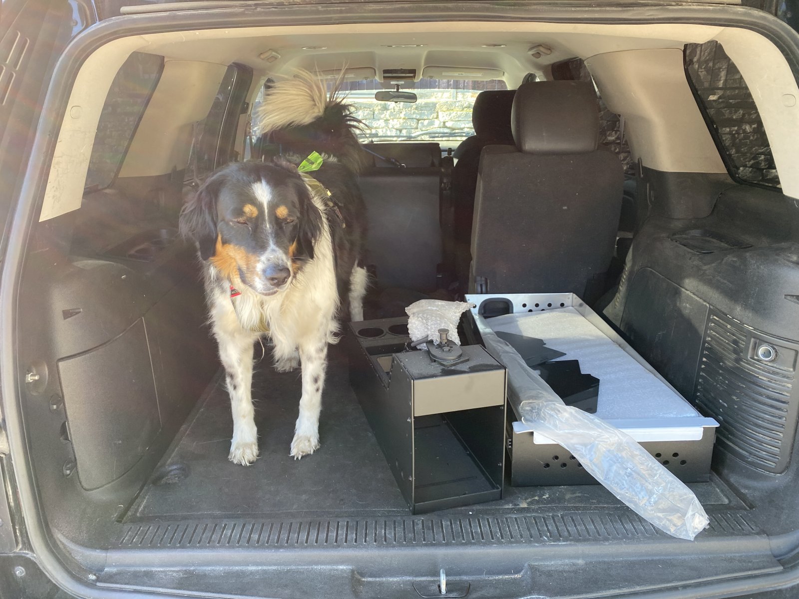

I scored a radio console and electronics drawer At auction from the state. I couldn’t tell from the photos, but they turned out to be brand new, just dirty. $12.50
Seen in theothertwin With the hound.

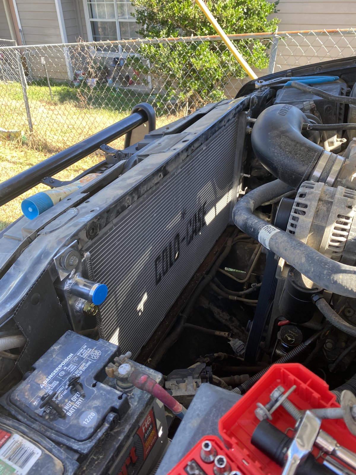

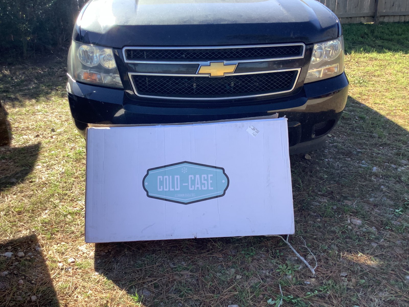

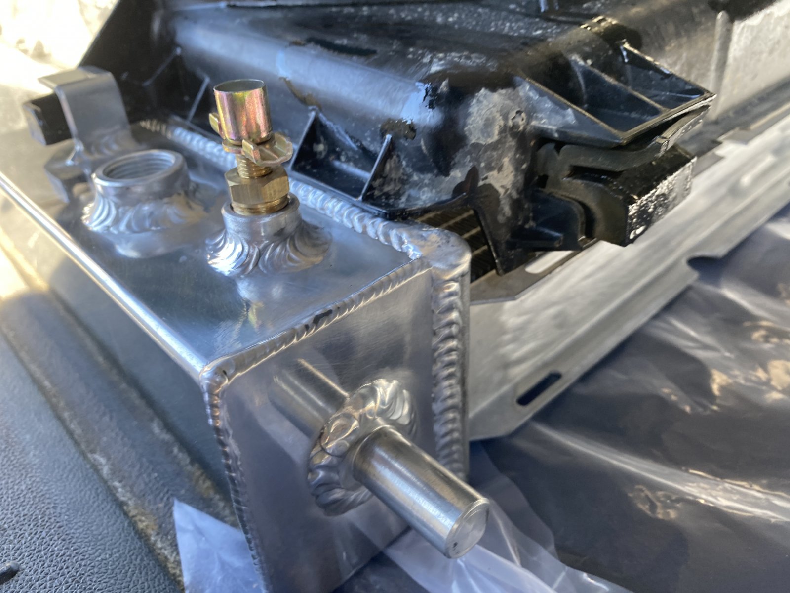

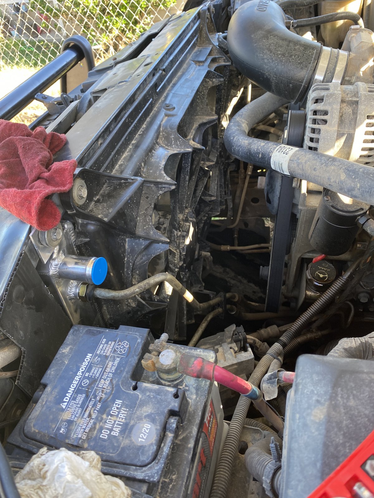

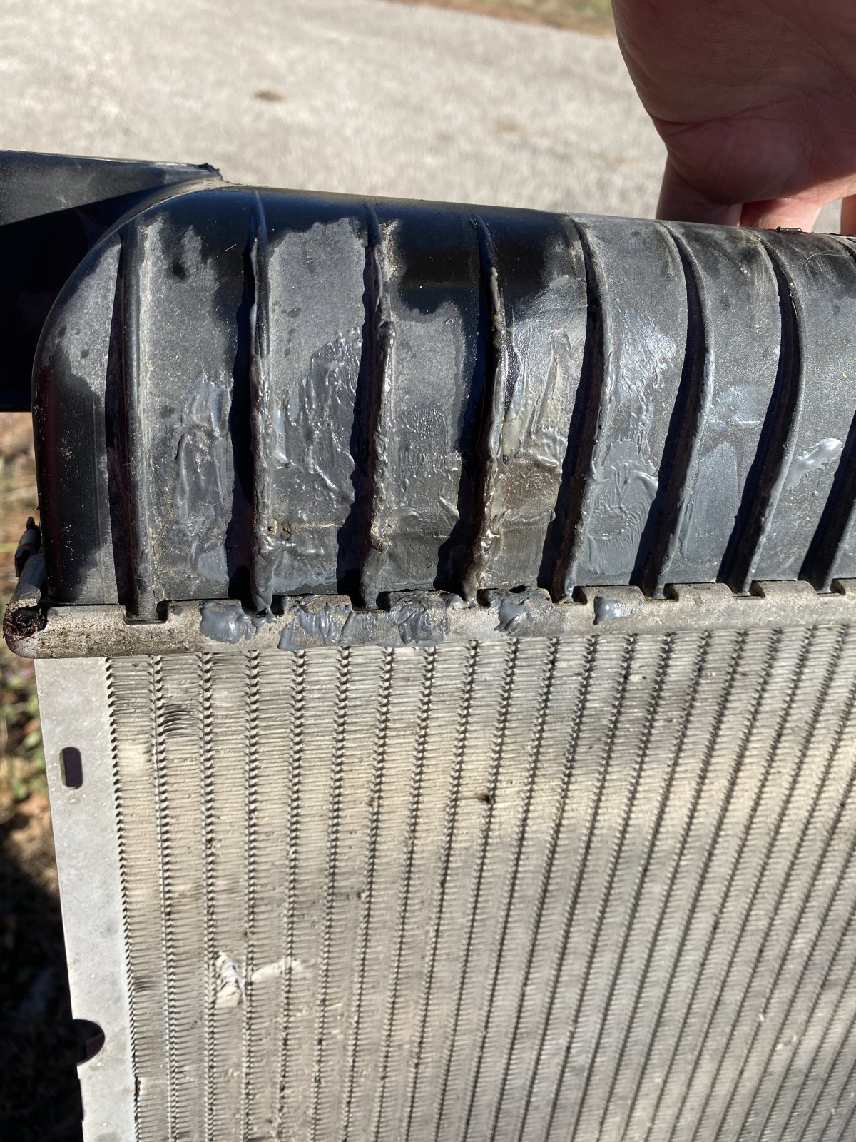

During a trip to Big Bend last week, the radiator in thecopcar burst the upper tank. About a 3” crack near the top. Some JB Weld and a loose pressure cap let me finish the trip and get home. Another 700 miles. After I got home the Cold Case I had been eyeing was ordered and delivered in 2 days from Summit in Fort Worth.
Apparently the design has changed a bit. I didn’t have to do any fan shroud trimming others have done in the past.
Sparksalot
Sparksalot
Sep 20, 2020
6,775
20,587
Bastrop County, Texas
View attachment 359797View attachment 359798View attachment 359799View attachment 359800View attachment 359801
After an engine warm up, then test driving about 20 miles I’m pleased. The engine is running 7-10 degrees cooler on the highway. The transmission is 25 degrees cooler.
