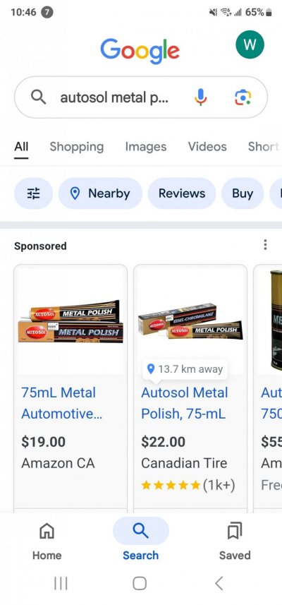

Screenshot_20241118_104632_Google.jpgWe used to use this kn the side covers of my Norton 50 years ago. Then my Harleys. They looked like chrome. If no go send the wheels to a powder coating shop. A good one will straighten and tune the wheels at the same time.

View attachment 442768We used to use this kn the side covers of my Norton 50 years ago. Then my Harleys. They looked like chrome. If no go send the wheels to a powder coating shop. A good one will straighten and tune the wheels at the same time.
The wheels are coated. Polish will not buff-out the defects, until the aluminum is stripped of the coating. Having said that, the wheels MIGHT be chrome plated, then coated? Then he'll need just a chrome cleaner.... AFTER THE COATING IS REMOVED.
A TON OF WORK...... Unless you send the wheels to a wheel restorer.
