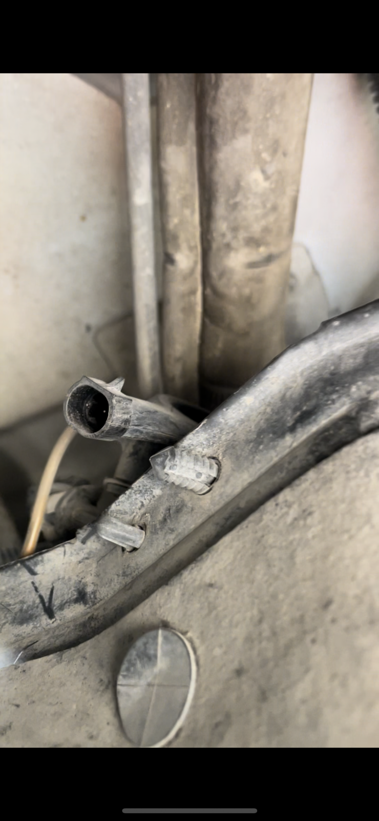

Also, inside of the box is this tiny little zip tied plastic o ring with a connection on the end that looks disconnected and I cannot find any harness that looks like ti wouldnt connect to it (enclosed photo) -anybody know what this is/does?

You should have a rubber line running from the compressor up to a location near the gas filler line inside the quarter panel that has a filter on the end, which is where the compressor receives its fresh air supply. Make sure that is connected. My first look at your photo suggests that this may be part of the fresh air line. Please check the inside of that connector to ensure that it has no electrical contacts inside of it, as that would suggest something else.
