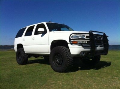

So I finally got around to doing the spacers and reindexing the keys.
Truck now sits at 44.25" to the wheel well on fresh 315/70/17s. Its now at that awkward height that I have to hop to get into the truck lol...
I can get away without extending the brake line (if I do anything I'll extend the Rough Country extension bracket another 1"). I'm ordering and adjustable panhard bar because the axle definitely sits a hair to the left now.
Pics or it didn't happen...

The portion of gray plastic between the door and fender is trimmed "hollow" so it allows for clearance but still physically looks stock. I do get the slightest bit of rubbing still at full turn between the rear portion of the front inner wheel well/fender area.

View attachment 186403 View attachment 186402
Looks pretty good! Definitely looks like you could use the sphon rear kit to re-center the axle in the center of the wheel well

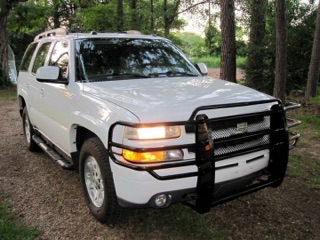

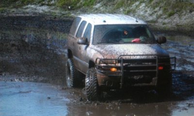

Looks damn good man! Here’s a few of my rig with 35’s on 6in before I went with a bigger set up.
E2F0F322-E890-487A-BDB1-11EF84445594.jpeg 1AB5E7C5-4695-4156-BAD9-EEE2F72D71F4.jpeg 46CB8548-CF40-47FD-9BEB-4E27974D12FB.jpeg
