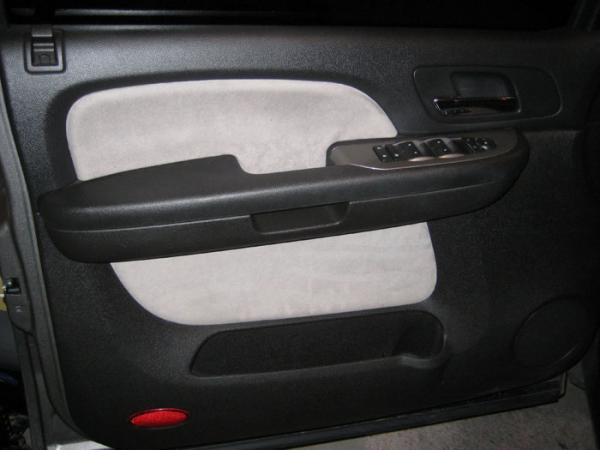

look in the sunday ads joanns ALWAYS has like a 50% discount just go grab like 2 yards it should be about $25 then go to autozone, kragen, hell even walmart and grab some 3M you can get 77 but lately I have seen the NASCAR 3M and it has a scale just get the medium grade it should work fine.
2 tools I found to be very important!!
both in this next picture..
first is to the left of the razor I don't know what its called but its nylon and has to different tips on the end PERFECT for tucking the suede in the groove on the top of your door.
second is a VERY sharp razor I can't stress that enough..
the first time I did the suede over the bottom carpet the razor I used was dull so it cut the suede jagged and turned out bad
the top part I made a cardboard cut out and put that over the suede and traced it a little bigger then shoved the extra in the groove and it holds.
I'm going to do it again and glue it I just wasn't sure if I was going to like the suede like you so I didn't glue it.
the trick is to keep enough on both sides because the suede I got is not real stretchy so it pulls from the opposite side, but like I said it turns out clean because everything tucks in the groove
then just use a sharp razor and cut an X pattern where the lock goes and that pulls it all together
I don't know if you want to do the handle insert so I'll wait to explain that one
theres the passenger side but the same goes for the drivers :)
hope this helps a little
-Kasey

on my door I left it on to do the top part, for the carpet I took it off and masked everything off..
second time I did it on my buddies left the door panel on but still masked off the rest of the door of course..
theres his turned out WAY better than mine but then again I had practice
