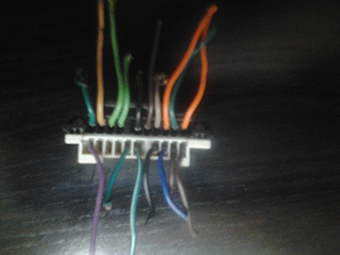

My stereo wire harness was spliced and rigged up so I went ahead and cut it off with plans to replace it. I looked up wire diagrams and color codes before I cut it, and it seemed pretty straight forward.
The plan was to cut it off, then hook up (without a harness) an old head unit to see if the 4 door speakers need to be replaced. The factory speakers have been replaced with Sony but I have no idea if they are any good.
Anyway as I was taping the wires I realized they weren't matching the "diagram" that I had, so I searched and came up with 3 different diagrams, none matching the wires I was taping.
It's a 2002 LS Tahoe. Has a factory sub which I don't plan to use.
Anybody have the correct color codes for me?
Here is what I have;
Black
Brown
Grey
Purple
Green/White
Brown
Green
Green
Green
Brown
Blue
Tan
Light Green
Light Green
Orange
Orange

Any advice? I'm going to a junkyard or 2 tomorrow. Hopefully I can match up a harness for these 16 wires

Thanks. Previous owner spliced into half of the wires and some were melted.

Should you decide you don't want to use the factory amp this site has a lot of information for you also I will try to put a picture on here for you with wiring color. Hope this helps.
2002 Chevrolet Tahoe Car Audio Wiring Diagramhttp://www.savagehomeautomation.com/projects/bypass-factory-ampcrossover-in-2002-chevy-tahoe.html
Car Radio Battery Constant 12v+ Wire: Orange
Car Radio Accessory Switched 12v+ Wire: Yellow
Car Radio Ground Wire: Black
Car Radio Illumination Wire: Gray
Car Stereo Dimmer Wire: Brown
Car Stereo Antenna Trigger Wire: N/A
Car Stereo Amp Trigger Wire: N/A
Car Stereo Amplifier Location: N/A
Car Audio Front Speakers Size: N/A
Car Audio Front Speakers Location: Dash
Left Front Speaker Positive Wire (+): Tan
Left Front Speaker Negative Wire (-): Gray
Right Front Speaker Positive Wire (+): Light Green
Right Front Speaker Negative Wire (-): Dark Green
Car Audio Rear Speakers Size: 6 1/2″ Speakers
Car Audio Rear Speakers Location: Rear Deck
Left Rear Speaker Positive Wire (+): Brown
Left Rear Speaker Negative Wire (-): Yellow
Right Rear Speaker Positive Wire (+): Dark Blue
Right Rear Speaker Negative Wire (-): Light Blue
Did you ever figure out which wire needs to be connected to the stereo head's remote blue and white wire?
I need to trigger the factory amp so all of my speakers will work.
I can't find a diagram with the correct wire colors, but you have the same wires as me.
Please help, Thanks
