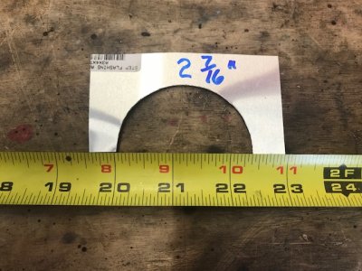

OK doing a bit more research and I have gathered the following data. Called a couple dealership parts department they do list the large rubber bushing for the Hydraulic NonHybrid models but say that it is not a separate part on the Hybrid wit Electric steering rack? It looks like the rack body on mine is 2 7/16" Outside diameter. I am going to go try to find and check a NonHybrid if I can find one somewhere. If it is 2 7/16" O.D. the silly bushing should work! Here is a YouTuibe of the issue. When this bushing wears and gets loose allowing the rack to move your toe constantly changes creaing some bad wear in front tires plus a slight thump at times.
Pretty silly to repalce the entire rack due to a bad rubber bushing

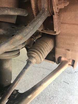

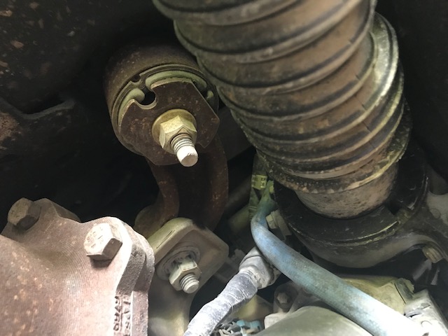

Got a couple of pics of the area and my pattern to check size. heistant to take it apart just yet until I have a possible replacement in hand. SOMEONE has to have run into this issue in the past???

None of my local dealers carry the part in stock (well one had it but over 50 miles one way LOL) The std hydraulic steering rack is the same size 2 7/16" as mine on the 09 Tahoe Hybrid Electric steering rack. So ordered a rubber bushing Genuine GM Part Number 22960484. Will be here May 10th. IF IT DOES NOT FIT I WILL BE BACK TO WARN YOU IF THIS IS NOT UPDATED EVERYTHING IS COOL AND GET YOU A GENUINE GM PART NUMBER 22960484 Bushing for your 2007 thru 2013 hybrid passemger side steering rack support no matter what the dealer parts guy says......I hope I do not have to update LOL.
I did check a std hydraulic rack at the auto parts to determine the rack body Outsdie Diameter and it is 2 7/16" same as the electric rack on the hybrid.

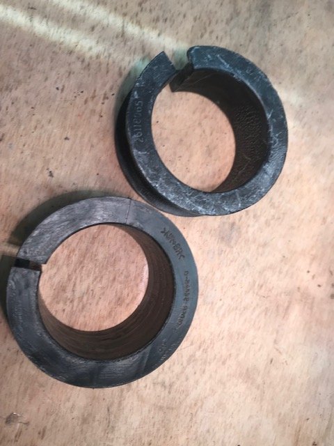

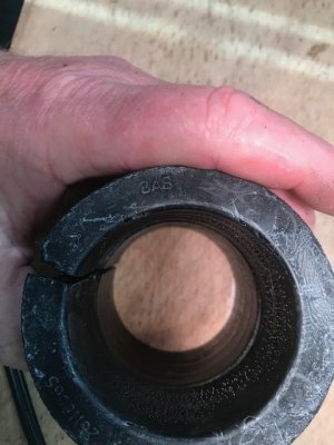

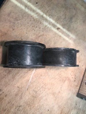

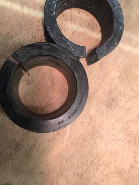

Dang it the new Bushing AC Delco part #22960484 DOES NOT FIT the Hybrid electric steering rack braket, the diameter is good but the width is too narrow on the new piece. (see pics below) I have the old bushing pulled off (marked NR+BR-0-S4532-B7010-A and it is much wider approx 1/2". Very disappointing! Back to square one on the parts search. I am going to attempt to cut some brass shim stock to tighten the old one up and reinstall it for now until I can get a replacement. I have contacted a steering rack remanufacturing company to see if they will special order me a bushing. I will update on the temporary fix and success or failure of getting the special bushing separately as progress is made.

Passenger side steering rack bushing is a common issue Hybrid or NonHybrid but since most alignment shops do not really check anything it can continue for years until lose enough to make noise and of course ruin your tires. The Hybrid was ahead of its time with an Electric steering rack but almost all other steering components interchange. The passenger side damper bushing is very close to being the same, it is just a little bit wider. Drivers side bushings are the same part number. OP how are you doing on your diagnosis so far?
