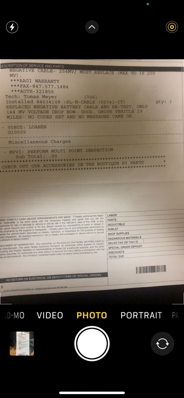

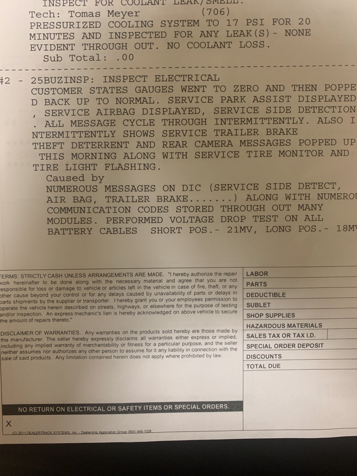

What sensors in the rear were replaced?
I was mistaken, that was for another error message I had - they replaced 3/4 sensors that time.
For the one you have, they put in a new neg battery cable for me. I was getting constant service brake system lights ans others . The pedal felt funny and would pulse a little. Invoice below …
